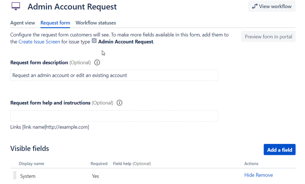

You'll need to create a custom dropdown field and add it to the screen the back-end Jira issue type uses. You can then add it to the request type so it's visible in the portal view.
Click the blue Add a Field button on the Request Form tab of your request type:
2021-05-25 12_36_22-Online Ordering_Call Center Service Desk - Ticket types - Jira Service Managemen.png

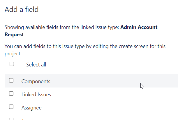

And then choose the custom field from the list of available fields.
