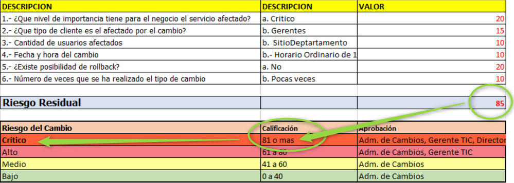

Para un requerimiento de Cambio (RFC), para Calcular el Riesgo del Cambio (Change Risk) se basa en una serie de preguntas que segun la respuesta se valora y se suma y este valor es comparado con los rangos de riesgos para saber si es Critico, Alto, Medio o Bajo, adjunto un ejemplo:
Como se puede implementar esto en la pantalla de Cambios en JSM?

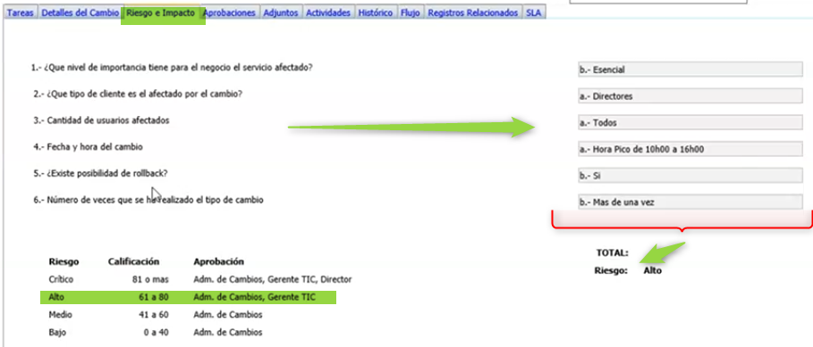

Our client has HP Service Manager, and in this tool they have implemented in this screen the Risk and Impact:
This screen is used by agents, the final users do not have to access to this. When the agent chooses the answers to the 6 questions, this screen automatically the values ​​are calculated and give as a result the Change Risk, the agent can review in the reference table on the screen the value range too. As you can see the values are managed internally in this screen, I don't know if this is posibble in JSM, for this reason, I think that values can be showen to the agent, the goal is calculate the Change Risk value.

Thank you for the details, @Administrador Jira ITSTK.
I’m afraid it won’t be possible to create a form exactly like the one you are using, but there are some options that may help.
The first one is by using a template available on ProForma. I found one that is similar to yours. The template name is “Change risk assessment”.
ProForma was acquired by Atlassian, but while the integration is not fully complete, you can use the Lite version that is free and you can create three forms.
The second option is also using ProForma with Automation where it’s possible to calculate values of fields and add the result on another one.
Please, take your time to review and test and let us know if you have any other questions.
