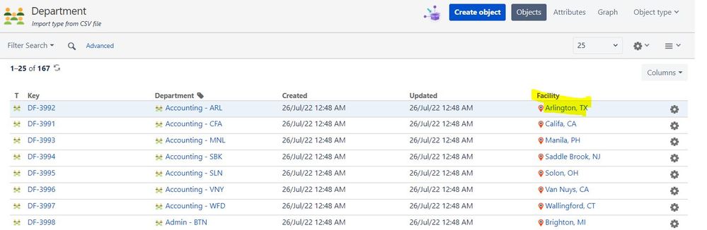

It works on the first try, as you can see here under "Department" object I used Name=${Facility} dept.JPG

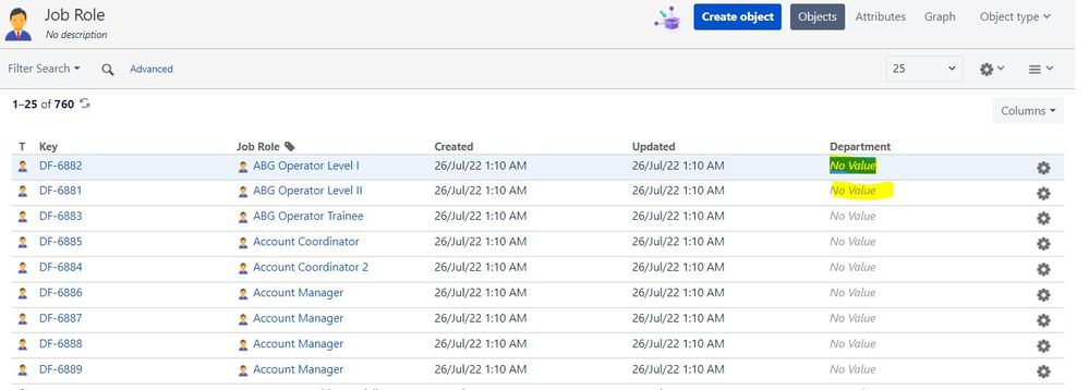

But when I did the same steps under the "Job Role" object and used Name=${Department} the values from the existing "Department" object are not showing

Is your header also called "Department" ? and is that value in the "Name" attribute?
Dannica Capistrano
July 26, 2022
Thank you so much, @Dirk Ronsmans ! It works now :)
Dannica Capistrano
July 26, 2022
I just replaced it from Name=${Department} to Department=${Department}
