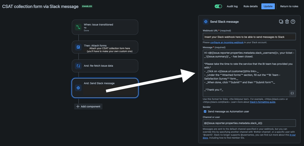

How I achieved having the CSAT form sent to users via a Slack DM was using JIRA Automation from within the relevant project. After the sync script had run, I created an automation with these steps:
  • In the "Send Slack message" action in the automation, make sure to set @{{issue.reporter.properties.metadata.slack_id}} as the user you want to send the message to (in our case it would always be the reporter, because they logged the ticket and the team wants feedback from the reporter).

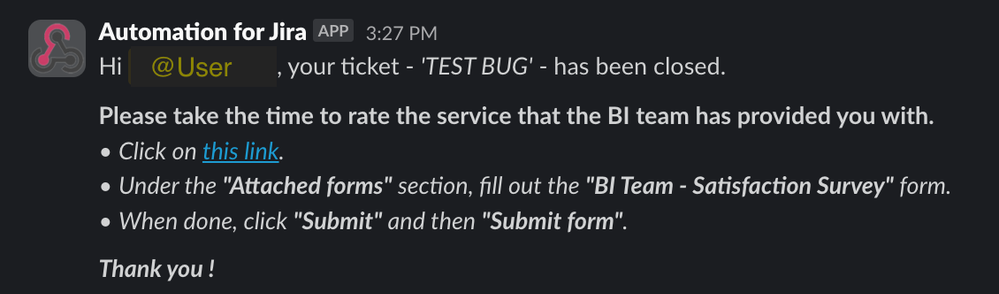

Then, the message should come through to the user from the Slackbot:
