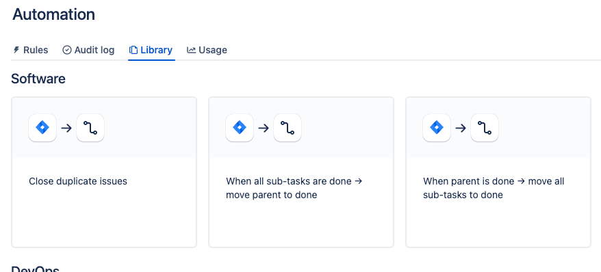

What you describe above can be done. There are template rules in the Automation library that you can use as a starting point. The two shown below that mention sub-tasks and parents are the ones you want to look at.

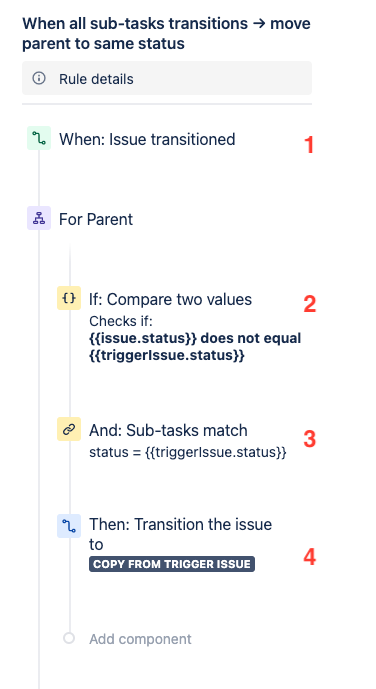

For the change Parent issue based on Subtask, you would need to make changes to the rule as follows.
1. If you want the parent changed regardless of the Status value selected for the subtask, you would remove the Status value selection in the trigger.
2. You would want to check that the value of the parent Status was not already the same as the value of the subtask status. This requires the use of an Advanced Compare and a smart value.
3. If you want the change to happen only if all the subtasks are set to the same status, you need to change the condition that checks the value of the other subtasks to also use a smart value rather than an explicit Status value.
4. In the last step where the issue is transitioned, instead of explicitly setting the status of the issue you would want to instead use "Copy from trigger issue".
Here is the documentation home page about smart values.
https://support.atlassian.com/jira-software-cloud/docs/what-are-smart-values/
Using those hints you should be able to extrapolate to make similar changes to the template for changing the subtasks when a parent Status value changes.
