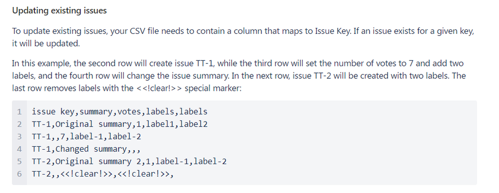

So, we've had a company realignment and I'm trying to bulk update all our pre-existing Users details. According to Atlassian this should be fairly straightforward, but mine just keep creating new users
This is the information I'm going off: Import data from a CSV file | Atlassian Support

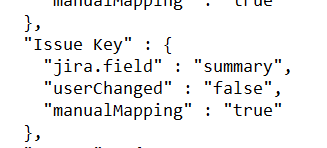

My config file I'm using to import:

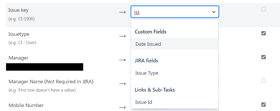

The available fields I get when I import:
