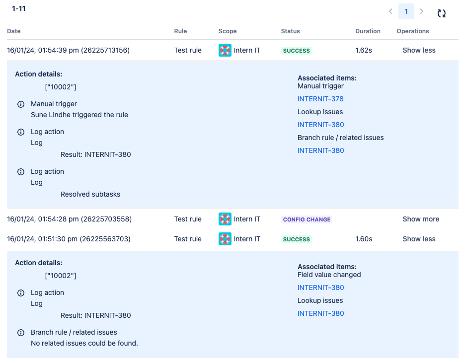

The log for the two executions is here:
Any thoughts anyone?

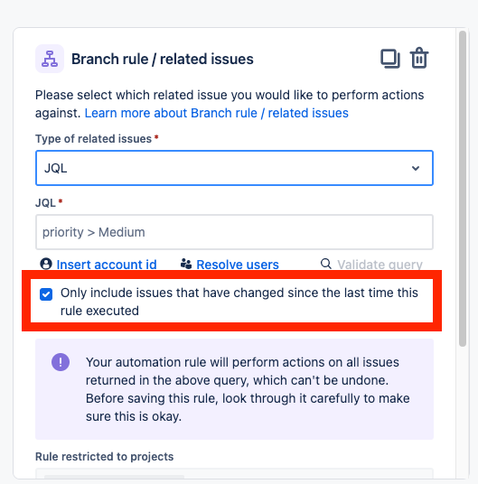

Is this box checked or unchecked in the For Branch?
