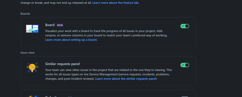

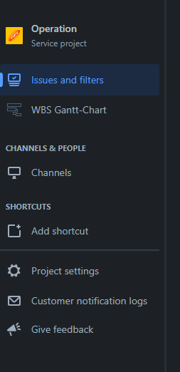

I created a Service project for my team and the board feature has been created but none of my team members can see the board or have excess to it - they do have access to the project and can see the issues created.
Also, they don't have many of the features I have.
How can I share the board with my team?
Thank you.

Yaharin
February 21, 2024
There is no Board feature.

Welcome to the community !@Yaharin , have you checked Project Settings -> Features -> Board (this needs to be toggled on)?
Yaharin
February 21, 2024
Yes. Its on.

Yaharin
February 21, 2024
Done, Still no board feature.
