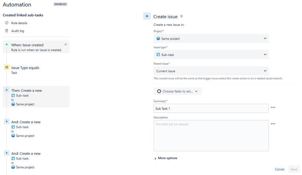

Estoy intentando crear una incidencia con varias subtareas. Las cuales han de realizarse en un orden exacto.
¿Hay alguna forma de hacerlo?

Hello @Luis Alejandro Deobarro Navarro
For creating subtasks in a particular order for any issue, Automation can be used.
The details of the automation rule are as:
  • Trigger - Define when the rule should be run; for this case select - 'When the issue is created'
  • Condition - This limits the rule to be run for specific conditions and not for all issues; for this case, you may define it for a particular issue type
  • Actions - This defines what all activities should happen; for this case, select the creation of sub-tasks with all the details.
Please find below the snapshot for a similar automation rule.
Kindly accept the answer if this helps and feel free to share any further queries.
--GG
