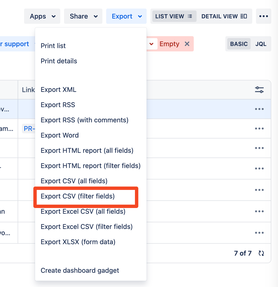

Hi @Kieran McCormick ,
You can always create a Search/Filter and then export to Excel. Then create a custom report / presentation based on the data exported:
Alternatively you can use one of apps from the Marktetplace to create the report you need right in Jira with options to export/share the result. But that comes with the cost of the app.
So basically it's a cost of manual labour to create and maintain the report(s) you need VS paying for the app.
Hi Dmitry,
I've had a look and I can't seem to find a way to export on this based on your screenshot, is this on a different view?
Yes, I was referring to Search View / Issue Navigator. You would need to search for issues in your "Marketing and Communications" project.

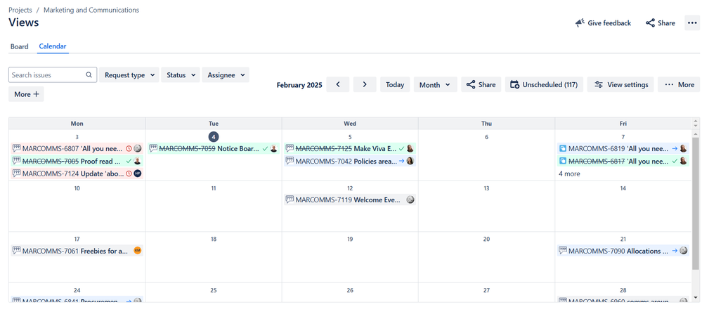

Hello Trudy,
Thanks for your help with this, we've activated the calendar view now so that should cover the deadline query from this post.

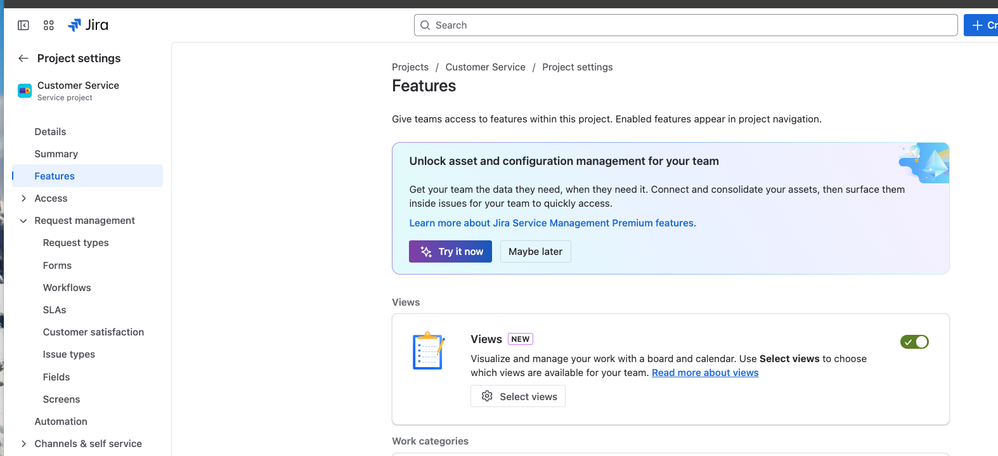

You can definitely add a Due date field to the issues in Jira Service Management, separate from the SLAs you define. Setting the Due date by itself doesn't add any functionality like reminders when the due date approaches. There is a Views feature being rolled out for JSM that includes a board and a calendar.
The Calendar option would be populated if you start using the Due date field.

The Jira Service Management project includes a Board option in the Views feature. That presentation is similar to Trello.
Given that you have only JSM, you would be limited to using the JSM project features for your "project plans". The use case for JSM is more oriented to customer support and incident management, so it doesn't have many features that are geared towards project management.
