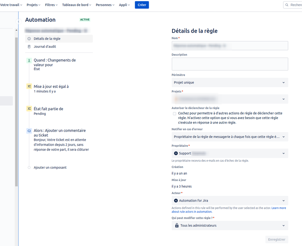

I create an Automatisation task and I don't understand why it tells me "The following tickets did not match the condition"
My actions are simple:
* Field value changed: status.
** Type of change: any change.
* Update is equal to 1 minutes ago (for the test)
* State is part of pending.
* THEN : Add a comment.
It sees the change in my ticket, but does not comment.
Do you have an idea ?

Marie Laplise
January 3, 2023
Hello @Walter Buggenhout ,
Thank you for your answer,
In the future, I would like to warn my users that if they do not answer the ticket will be closed.
"State is part of pending" is a condition.
Attached is a screenshot,  in French, sorry  :

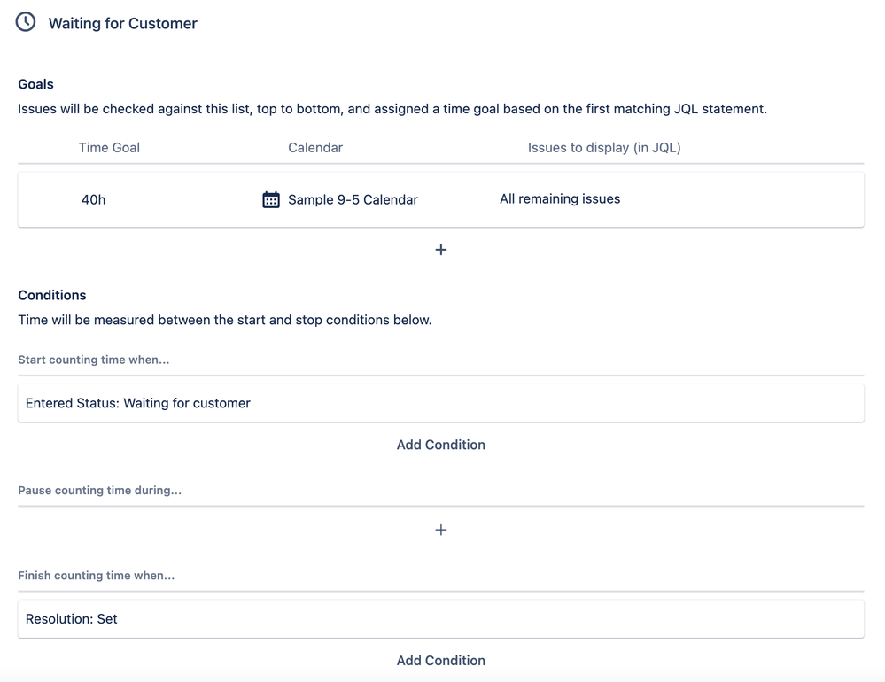

I believe it would be easier for your use case to use the SLA's to set up what you are trying to do. I think you are describing a classical use case where an issue enters status Pending (and thus requires an answer from the customer) and you want to close an issue automatically if you wait too long for a reply. You expect an answer within 40 hours after entering status pending, if I understand correctly.
You may create an SLA that looks like this:
obviously update the conditions to match your statuses and workflows.

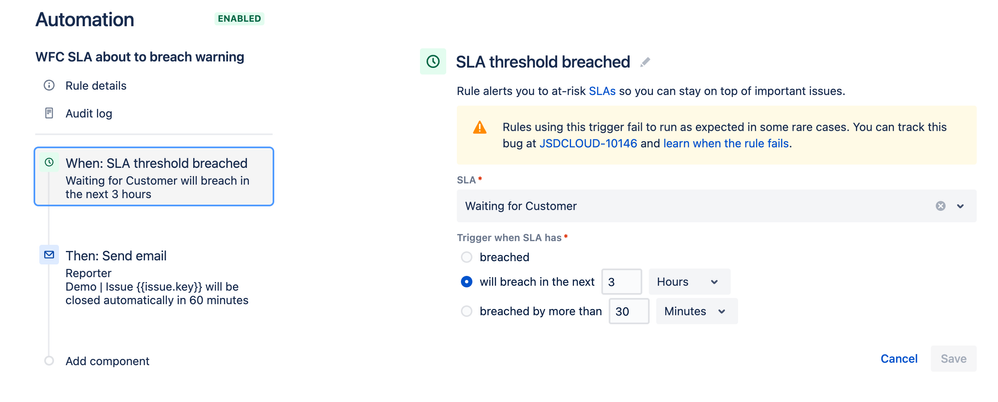

Then set up an automation rule that responds to this SLA like this:
Screenshot 2023-01-03 at 14.52.56.pngThis rule will send out a message 3 hours before the SLA target is reached. So in the example after 37 hours of waiting time.

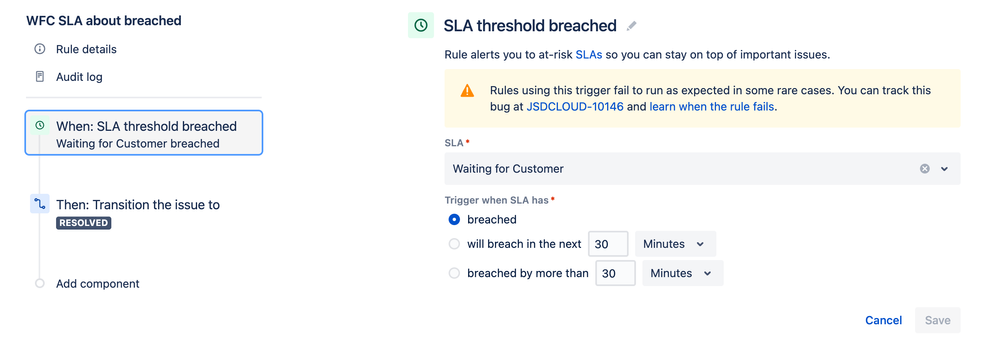

You can even use the same SLA to automatically close the ticket when the SLA target of 40 hours is reached:
