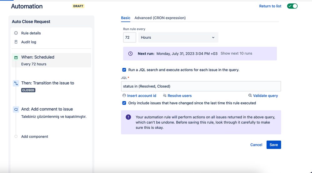

Merve Bilgin
July 28, 2023
Is it true ?
Like John Funk likes this
John Funk
July 28, 2023
Click off the box for Only include issues that have changed.
Also, you need to include the timeframe in your JQL. So add something like
AND (status changed to Closed after startOfDay(-3) OR status changed to Resolved after startOfDay(-3))
Like Merve Bilgin likes this
