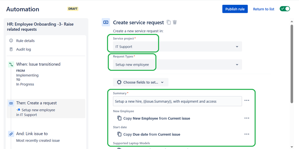

The most recently created issue will refer to the one in the rule - not some other issue that might get created at the same time. So in the rule posted below, it will refer to the issue immediately before the Link action.
Or you can add a Branch after the Create a request action and use Most recently created issue for the branch. Then move the link under action under that branch.

I was just investigating this in my test instance. If you create this rule, instead, as a global automation, you have the option to create directly on the transition a service request, like this, where you can then specify to copy any and all fields from the original issue using the 'Choose fields to set' option next to the cog. In the example here, you can see that I can either SET a value, like I am doing in the Summary or copy from the source issue, like I am doing for the New Employee and Due Date fields.
Please can you try this approach and let us know if it works for you?

@Valerie Knapp for linking the issue you used the most recently created issue right, its a service management project, what if some other issue gets created while this automation is running, in that case the newly created issue will be linked not the issue which transitioned to the designated status.
Am I right?
and I tried with the trigger issue option and the rule was working properly, audit log says success but the issue was not linked to the other project
