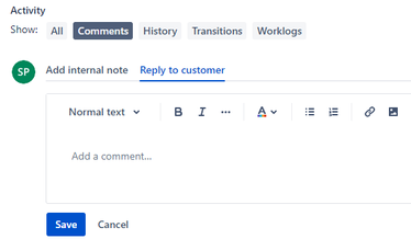

I try to create the following:
when I click on "reply to customer" next to "internal note" in a request or whatever, the status should change to "waiting for customer" right after sending the message to the customer.
currenty I have to click on the status "waiting for support" and select "waiting for customer, to change the status.

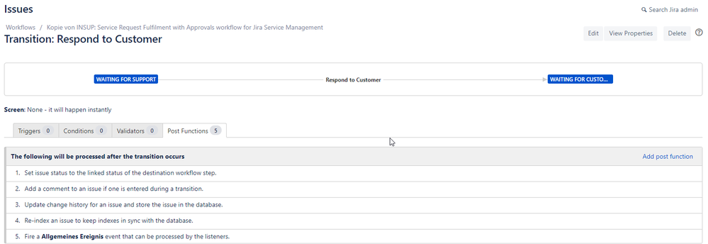

But there is no rule or what ever within the workflow... where is it coming from?
We dont have an active automation in this project oder a global automation or sth. so it is sth within the workflow, isnt it?

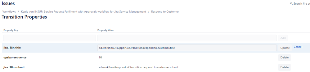

Or is it coming from this:
I copied these Properties into another workflow and it didnt work..

This is already solved.. it is because of a translation issue.
we have an automation within the "legacy automation" which is changing these status.
But if you work on it in german, "legacy automation" is translated in: "ealier automation site".
so I didnt check that, I thought this would be like a view of an older automation version or sth...
