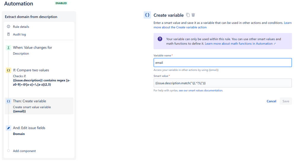

Extracting the domain information from the description could be done using an automation rule with REGEX. But the risk of error is high if the description does not follow a predictable structure.
Check out this article Extract Content out of Description and Summary with Regex and Automation
It will give you some examples and best practices on how to use REGEX to populate fields.

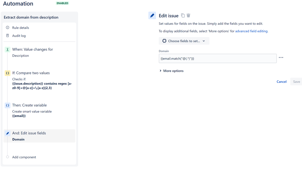

If you are able to extract the email from the description, you can use it to create a variable and then use another match to extract the domain. More complicated domains may pose a challenge, such as "domain.co.uk"
The screenshots below are an example of what I just wrote above. Do not use this example rule as it is. Having a second email address in the description,  or an unusual domain name, will break this rule. It also assumes that the address in the description has been converted to a link during editing (e.g. [name@domain.com|mailto:name@domain.com]  Depending on how your description is being edited and formatted, this may not be your case.

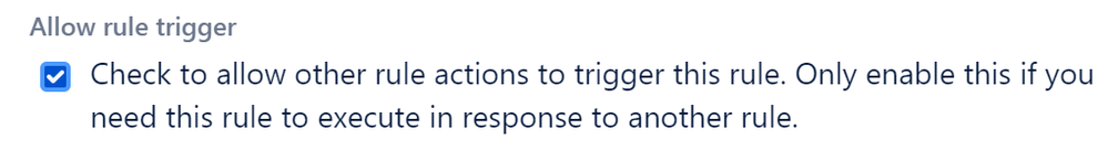

Once you find a way to populate your field automatically, you can use the linking rule you already have to create the links. But you will have to allow that rule to be triggered by others, in the rule details screen
