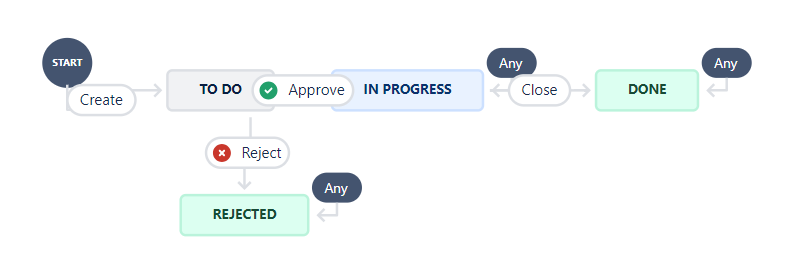

The workflow for the issue is as follows:

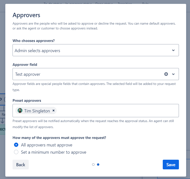

The approver in the workflow is as follows:

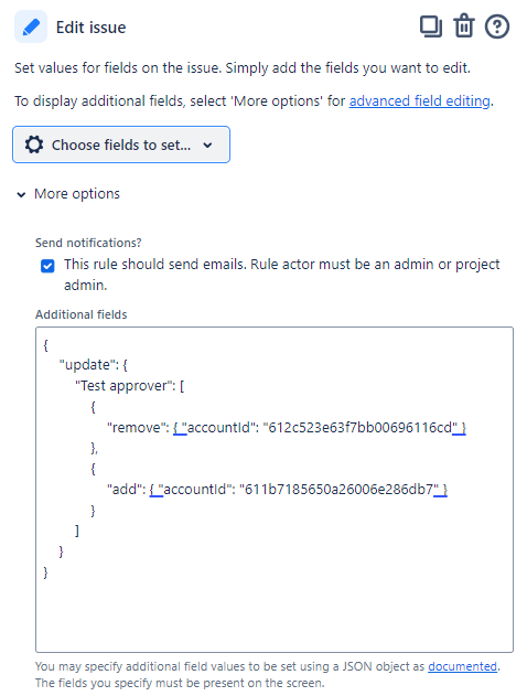

Step 3 is as follows:

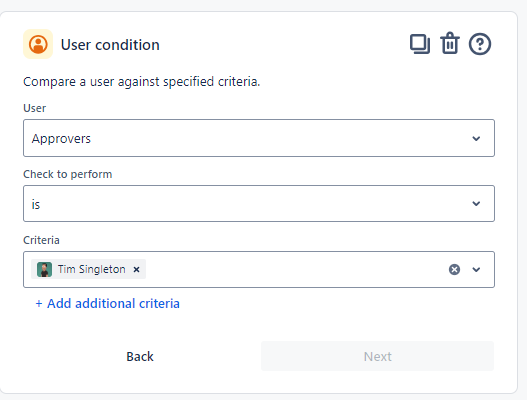

I have tried the following condition for step 2, but it does not trigger the workflow.

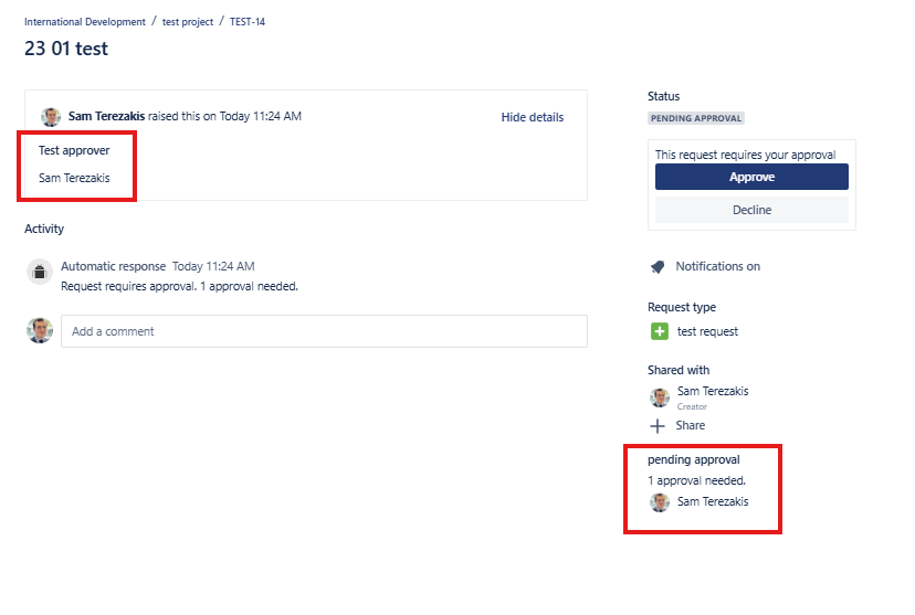

Here is a screen of the issue

I understand that the automation is not working as expected here.  Part of that appears to be due to the conditional used.  The comparison seems to be looking at the default "Approvers" field.  However in your example you appear to have created a "Test approver" field instead.  Adjusting that might be all that is needed to correct this.  But then again it might not be enough to resolve the problem.
The next problem is in regards to the JQL search.  In order for you to get results of that query, your account has to first have permissions to see the Jira issues in question, but also your account will need to have a JSM Agent role. Your screenshot shows a view of the customer portal.  Any user in the customer role could potentially see the customer portal, but to view the issue (not just the request) within Jira, your account will need to make sure that it has the Agent role (for JSM product access) AND that your account has the permissions to view that specific issue.  One way of testing this would be just to run a JQL query of
key=TEST-14
to see if you can return that issue in the search results.  If you cannot, then your access to that issue might be restricted to the customer portal until you have both product access and project permissions to the issue.

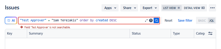

Thanks for the response. I have the correct permissions to view the issue. I have searched for the issue using the following query, however it doesn't return any results.
"Test Approver" = "Sam Terezakis" order by created DESC
 Note, "Test Approver" was created from the approval screen in workflow configurator and it does not appear in the list of custom fields from the global settings menu.
