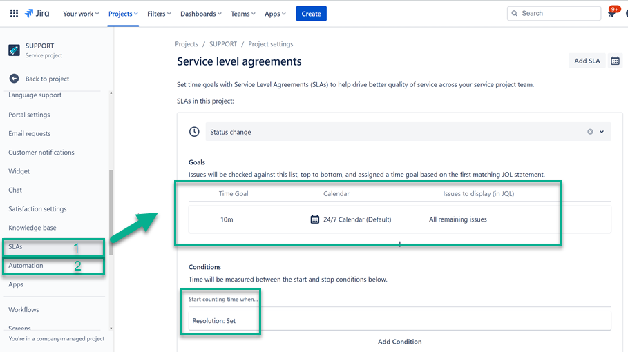

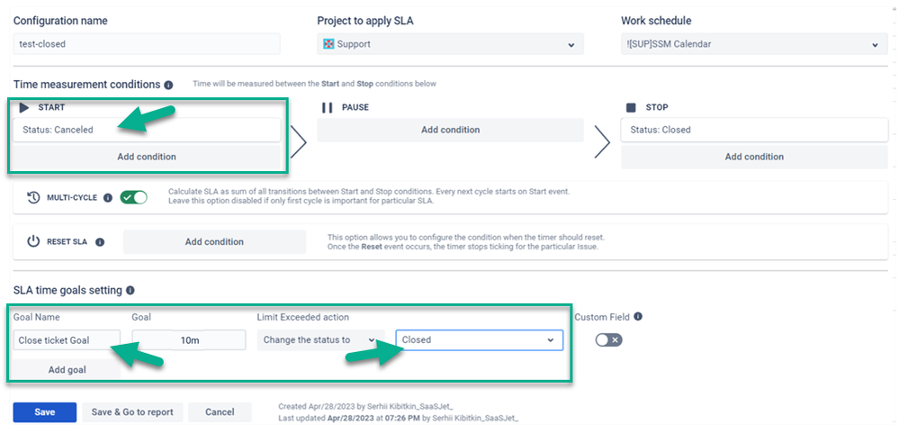

Kateryna_v_SaaSJet_
Atlassian Partner
April 30, 2023
Hi @Eleni Wagner-Oikonomi
Welcome to the community!
Here's an option to do it with SLA configurations using the SLA Time and Report for Jira add-on. Set the Start and Stop conditions and run the trigger for 10 minutes.
This will be the same for native JSM functions but in separate SLA and Automation windows.
