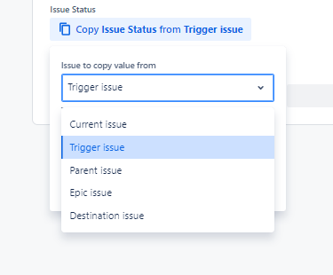

I know I don't want Parent or Epic.  If I want the status of Issue 1 to be changed when the status of Issue 2 changes, is this my Current, Trigger or Destination issue?
Thanks.

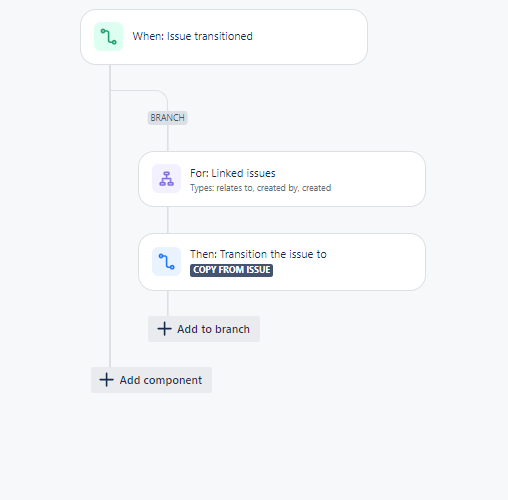

Becky Koronkowski
June 21, 2024
I've also tried this and it's not working:

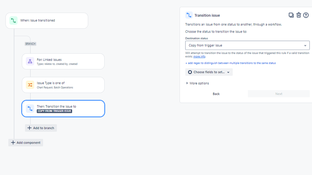

I figured it out with the help of Atlassian support.
If it helps anyone else here:
I didn't need the "Issue to Copy Value from" section filled out at all.  It should look like this:
Issue Type is one of was specific to my need but can be left out.
