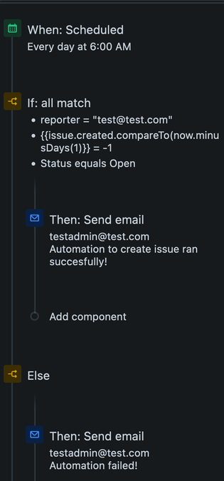

What you are looking for is something like:
  • Check daily after automation should have run
  • Check if there are issues from a certain e-mail address
  • Check if the issues are created since the previous day
  • Check if there are any open issues
I haven't run this automation in my environment, but this is what I came up with. Curious to hear how it is working out for you.

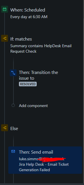

Luke Simms
March 27, 2023
Hi Paul,
Thank you for you reply and that looks like it should work and i've got the first part working correctly and the email for failure does not seem to send? It just says No Action Required on the logs. Any ideas of what i'm missing/doing wrong?

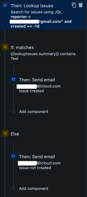

Paul Wiggers
March 27, 2023
Hello @Luke Simms
It looks like the if/else blocks need something to verify. If it can't find issues, it won't trigger.
I played around a bit and got it to work with this:
So, first you need to look up your issues with the Lookup Issues action, then perform the checks on those results. An extra benefit is that the required checks are a lot easier.
Shelby C
January 24, 2024
For anyone using this as reference - make sure you capitalize the I in Issues! {{lookupIssues}}
