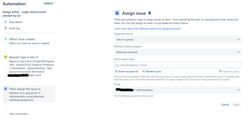

wisanu wirojtecha
September 27, 2021
Hi Callum,
This is the current setting for my automation rule. As you can see the trigger that I'm using now is when an issue is created.
I believe this trigger should be executed only one time when an issue is created. Just wonder it having the issue as I mentioned earlier.
Callum Carlile _Automation Consultants_
September 27, 2021
@wisanu wirojtecha Hmm yeah you're right.
Is it definitely just the one automation rule which is being triggered? You can check this by going onto the issue in your first screenshot and clicking on the Automations 'field', which will show you all of the recently triggered automation rules for that issue.
If it is just the one rule being triggered, does the audit log for your above rule give any clues? I.e. are there 3 logs created for the 3 assignments in your first screenshot?

wisanu wirojtecha
September 29, 2021
Hi Callum,
Yeah, you are right!!!  I'm found the root cause. It having some test rules that I'm created for testing purposes and it caused this issue.
Now I'm already disabled this rule. Hope this issue will be fixed.
