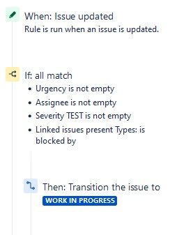

My first call was to go with:
When: Issue updated -> If: all match -> Issue field condition: field "x" is not empty, Issue field condition: field "y" is not empty, Related issues condition linked issue, blocked by, are present -> Then: trasnition issue to: work in progress
However this formula didn't work as expected, sometimes it was triggered, however most of time don't. I was also trying to use different configuration based on for example When: Issue linked or When: field value change however either of those were working.

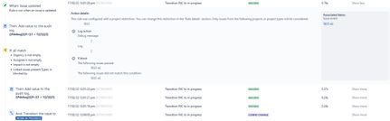

I hope i did everything fine, here is screenshot from the log, it's marking as success now after i add debuging, but still not working.

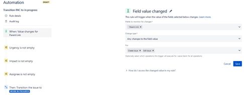

  • trigger: when field value changed (see screenshots)
    • check condition of link type
    • check if all required fields are not empty
    • regarding your update of the severity: as this field is updated by another rule you have to allow your transition rule to also be triggered by other rules (this is done in rule details by activating the checkbox --> see screenshot)

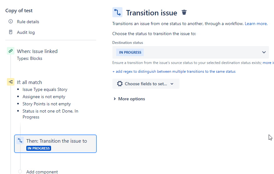

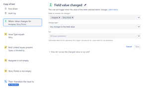

However still not working... but now i believe i'm making some mistake with configuration. can you take a look and let me know if that would be correct what i have done? Many thanks in advance.

There is a special trigger for "issue linked". As I got it from your description one of the conditions is the linking of type "Block" --> see screenshot. The "issue linked" trigger could listend to this special event (Parent link will not trigger this). You could check the audit log to analyze whether the rule was triggered and if why wasn´t the action processed. In case the rule still doesn´t work: please also add the screenshot of the audit log from an expected run of the automation rule.
Hope this helps and we are coming close to a solution ;)

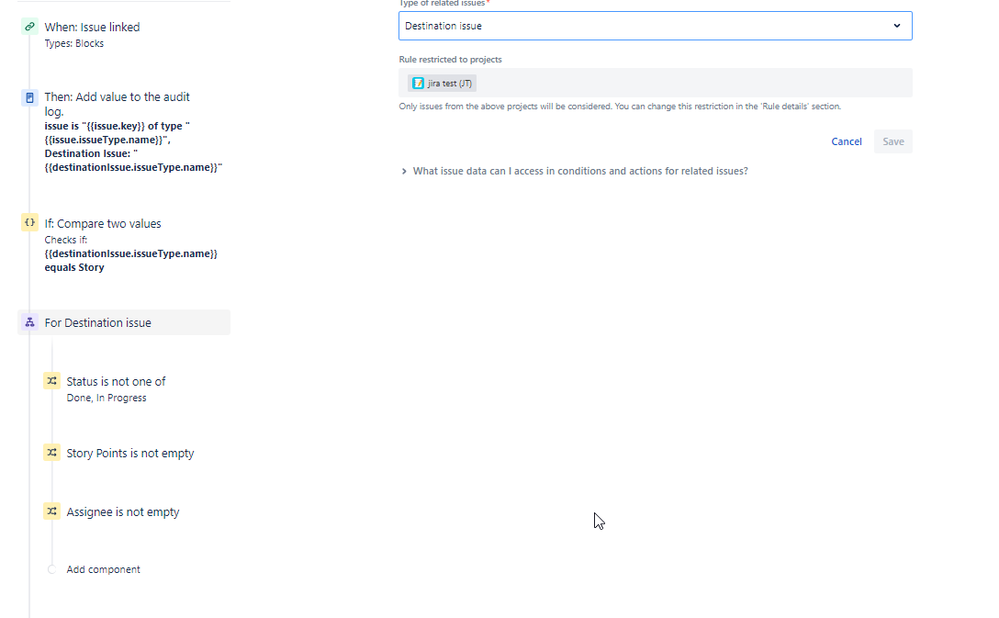

I´ve set up a rule that I guess will meet your requirement (see screenshot):
  • action log was just for analyse and can be left out
  • conditions in the destination branch need to be set according your conditions
  • transition action needs to be added in destination branch after conditions checked

 That's the correct approach, and adding those almost the same as you did have solved my issue. Many thanks for all the help you gave, that was brilliant i really appreciate your effort.
