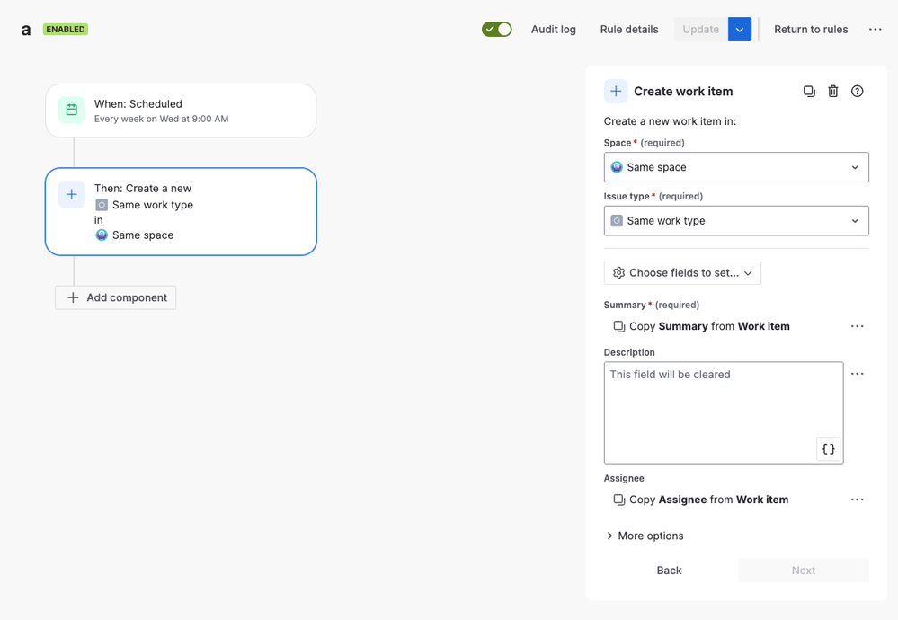

If I create the work item manually, both assignee and approver fields are on the create screen and I can set their values.
My automation rule is triggered on schedule with a JQL. For each matching work item, I create a new work item and copy some fields over.
I tried using the COPY option for Assignee and Approvers at first. Summary and Description are copied, but Assignee and Approvers remain blank.
Then I tried setting a fixed value as above. Still blank.

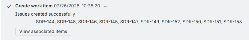

The audit log just reports success and this:
As said, if I create a work item manually, the Assignee and Approvers fields are seen on screen and I can set the same value as the rule into it.
The rule does copy Summary and Description successfully, while leaving Assignee and Approvers empty.

I created a simple rule with a Scheduled trigger to run a JQL to get a specific item and Create a new item copying the Summary and Assignee from the item returned by JQL. The Assignee is being set correctly in the newly created item. Automation for Jira is the Actor for my rule.

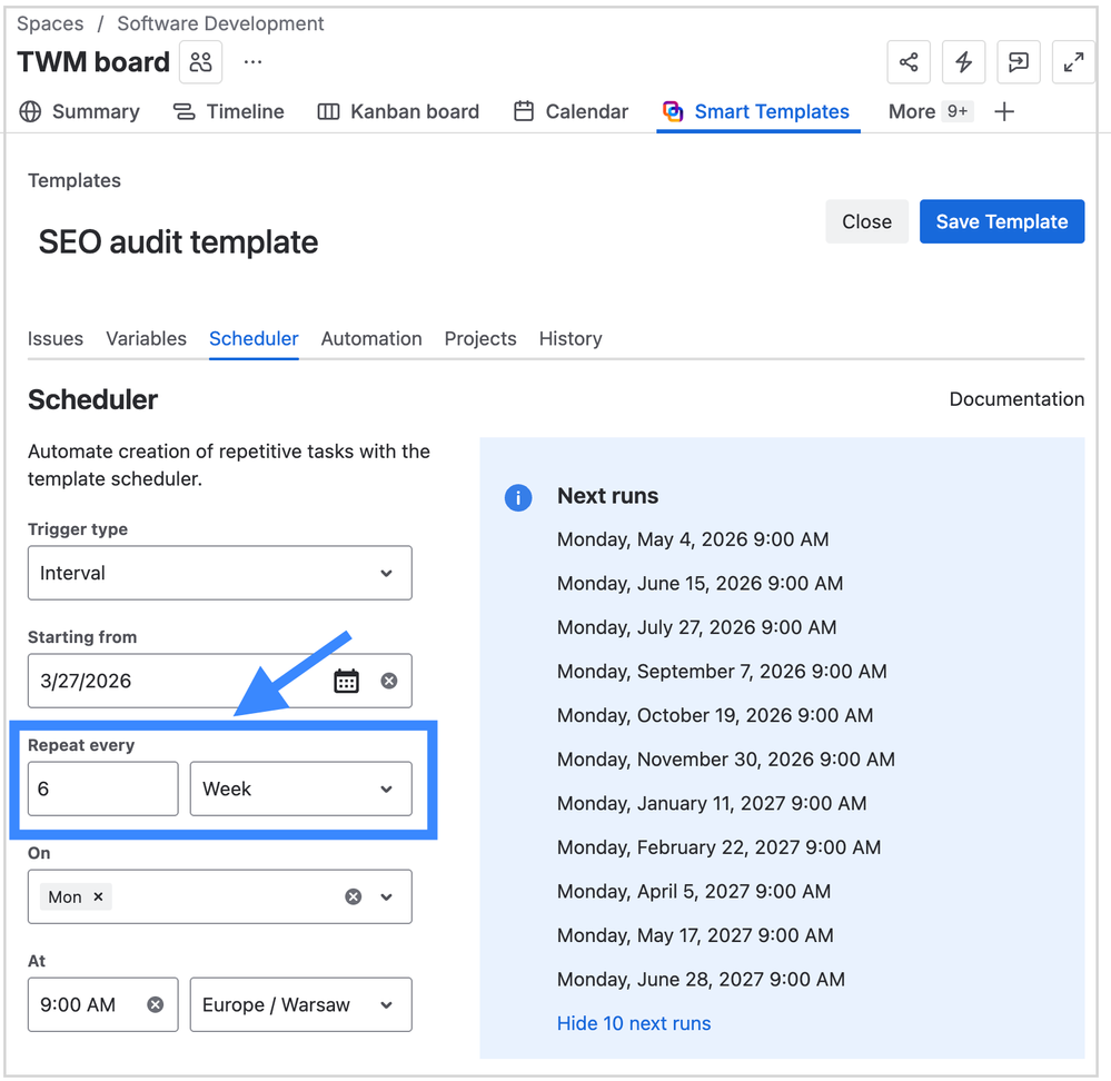

hi @KC Wong !
I can suggest a different approach to this.
Instead of relying on automation rules to copy fields from one work item to another, you could create a reusable template for your work items. In our team, we use our solution Smart Templates for Jira for such cases. The idea is that you save a work item as a template with all the fields pre-filled - summary, description, assignee, approvers, custom fields, and even child work items and checklists (if any).
When you need a new work item, you can create it from the template in one click or set up a schedule to create it automatically. No Jira automation rules needed: this can be handled on Smart Templates' side, although integration with Jira’s native automation is also possible.
I hope this helps! Let me know if you have any questions.
