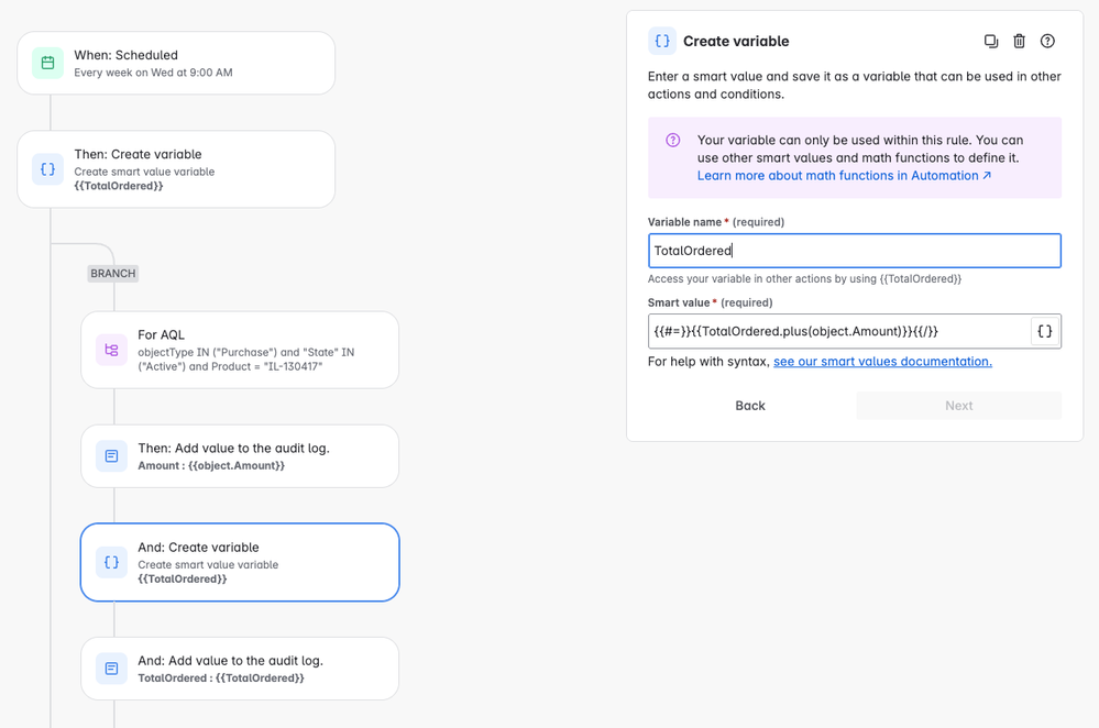

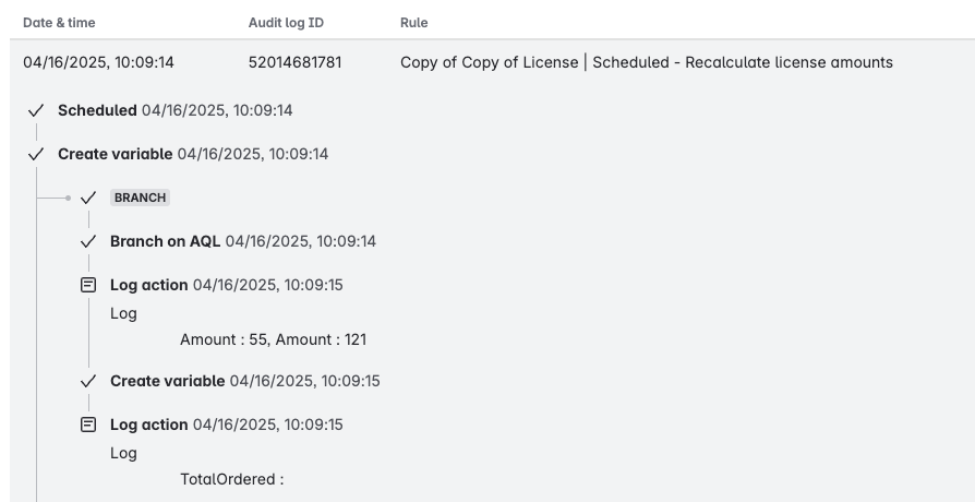

Kris Dewachter
April 16, 2025
Hi @Marc -Devoteam-
Thanks for your feedback. Unfortunately, I am not able to get this to work.
I also tried some alternative setup, which also doesn't seem to return the total.
Any thoughts on what i might be doing wrong ?
