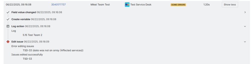

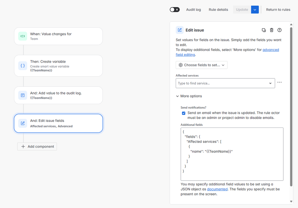

I am writing an automation to look at the team field when an issue is created and set the affected service of the same name. In my testing the affected service is not being set but I am not receiving an error either. I am not great at json so I am wondering if my script needs adjusting and perhaps what might not be set correctly. Thank you!

Hi @Mikel Whipple
I see a few things to check in the rule images you show...
First, the Edit Issue (or Create Issue) action may only update a field one way in a single action: with the field dropdown list or with JSON.  You have selected both.  Please remove the field from the dropdown list, update your rule, and re-test.
Next, have you confirmed your value exactly matches one of the defined values for Affected Services?
Finally, if the smart value does not work, perhaps try the custom field ID for Affected Services in the JSON.  You will need to look that up from an example work item, perhaps using this how-to article: https://support.atlassian.com/cloud-automation/docs/find-the-smart-value-for-a-field/

The article you posted was a ton of help, when I tested other variations of the JSON I still cannot find one to work. From the article it says to know the type of field you are wanting to change, although Jira does not list what type of field affected services is from my determination I am going with multi-select. Then from there I could either use update and set or field. Trying field I get a success but it does not set the affected service in testing, I have determined the Team and Affected Service are the same name. Then I used the update and set operation, knowing that I want to clear anything in that field and then set it. This gives me an error that affected service is not an array. I am still back to square one. Thanks for the help though, I might have to open a support case.

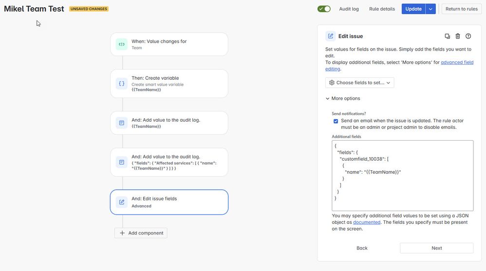

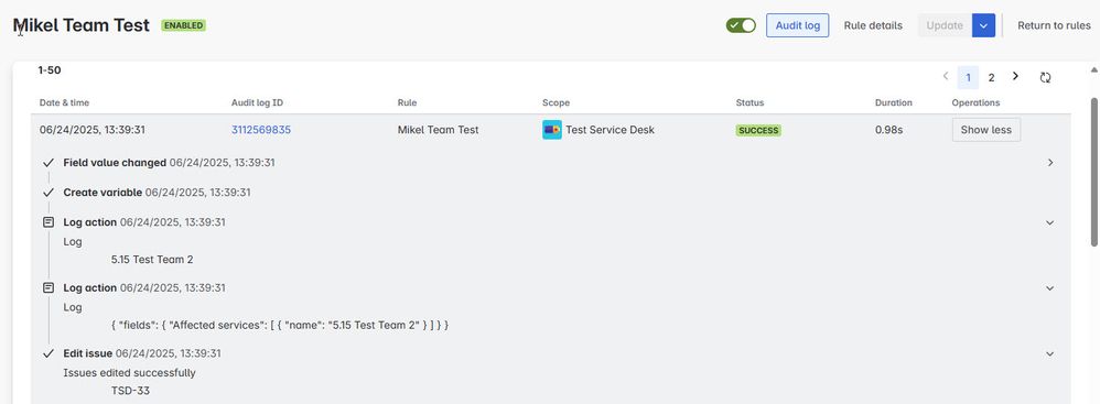

Let's try these...
Add another Log action before the Edit Issue action, pasting in the entire JSON expression, and then run your rule.  After it runs, post what you see for the log.  This will help indicate why the rule does not accept that JSON.
Next, please use an example issue (e.g., TSD-33) with this how-to article to find the custom field ID for "Affected services": https://support.atlassian.com/cloud-automation/docs/find-the-smart-value-for-a-field/
For some fields, rules require the JSON to use the custom field ID rather than the smart value for the field name.

I have updated them and ran the test.
Bill Sheboy
June 24, 2025
Ah, so the custom field was required for this one as the rule succeeded.

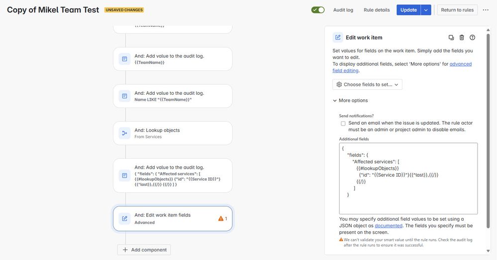

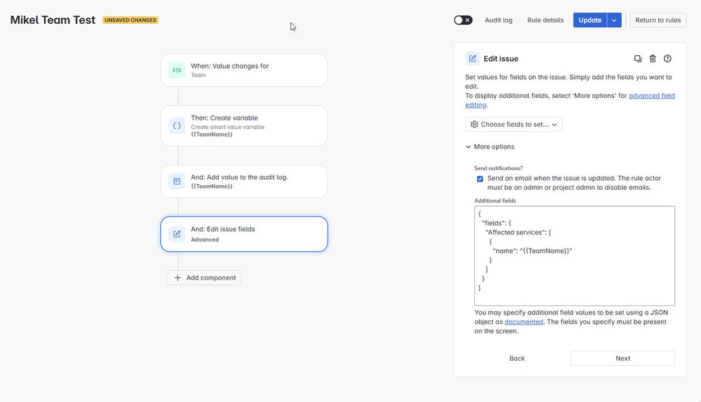

Update. After working with support came to find out that the affected service field is tied to asset so I built an asset object lookup and then had it set the affected service based on the asset object it found. Still it is finding everything it needs but it is still not setting the service. Now in opsgenie we did this using the API, I might have to switch to use the Jira Ops API to set the service. teams automation  pic 5.jpg

Thanks for the update, and...there appears to be a missing curly bracket at the end of the JSON you show.  Is it indeed missing, or is it just outside the view due to extra line breaks?

yep and not it works! Thank you sir, I owe you a beer.

Thanks for this folks, had a use case where we wanted to set Affected services field based on a previous asset object customfield we were using that was tied to our original scheme for Service type objects... essentially we wanted to lookup the name of the object in the old field... and then populate object with equivalent name in the Service schema to the Affected Services field. Anyways, long story short, it works and kudos to you for the pointers! Cheers
