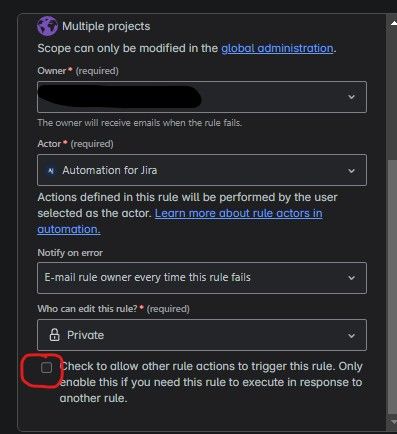

In your automation rule, please check if below option marked in RED is checked?
Please check this option and see if it works?
It did not work. I was able to use another suggestion.
