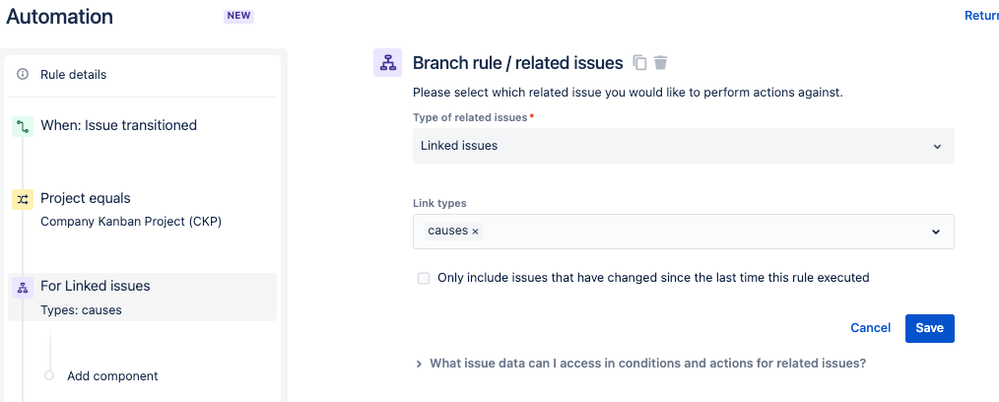

Next add a For Branch / Related Issues / Linked issue step. Do you have a unique link type that you are using between the software and service issues? It would make things easier if they do because then you can select the link type and know you will affect only the linked Service issues.

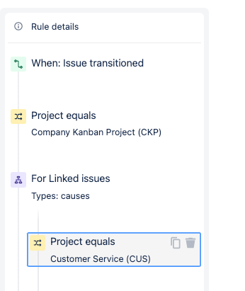

If you don't use a unique link type between the software and service issues, then the next thing you want to add is Condition(s) to select only the Service issues you want to affect.

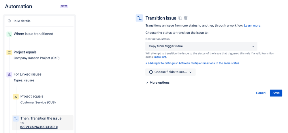

The next step would be to add a steps to transition the Service issue. However, the exact steps could be complicated by the answers to the above two questions. If you use the same status values you can use the Transition Issue action and use the option to Copy from Trigger Issue.

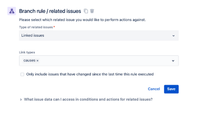

Should I still have the Branch rule/related issues like the below or should this be skipped or should I do any other choice in this section?
Screenshot 2023-05-15 at 15.25.00.png.                                  If it is easier and better to use the unique link type then I can of course also add this if it isn't too difficult.  Is this something that is configured on the software project side?

What link type do you use to link these software and service issues to each other? Do you use more than one type of link to linking software and service issues together?
If a software and a service issue are linked together do you always want to update the status regardless of the link type?
If you always want to update the status regardless of the link type between the software and service issues, then in the For Branch select all the types of links you use to link software and service issues to each other.
If you don't have a unique link type that you use only between the software and service issues, then also add the condition I mentioned as the first sub-step in the For Branch to ensure you update only the linked issues that are in the service project.
If there are situations where there are links between the software and service project issue when you don't what to update the status of the service issues, you'll have to figure out what the conditions of those situations are so that you can include them in your rule.

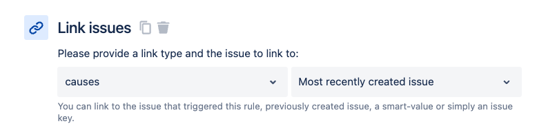

@Trudy P Claspill  - So i discovered that I had probably only created an automation that made a copy issue in the sw project and not a linked issue. The first picture shows what I previously had done and now I have made som changes and added the And Link issue to. and I used the Link type "Causes" (like the third picture shows)
Screenshot 2023-05-16 at 15.24.16.pngScreenshot 2023-05-16 at 15.46.34.pngScreenshot 2023-05-16 at 15.49.22.png
So now I will get back your instructions above and see if I can get it to work.  :)

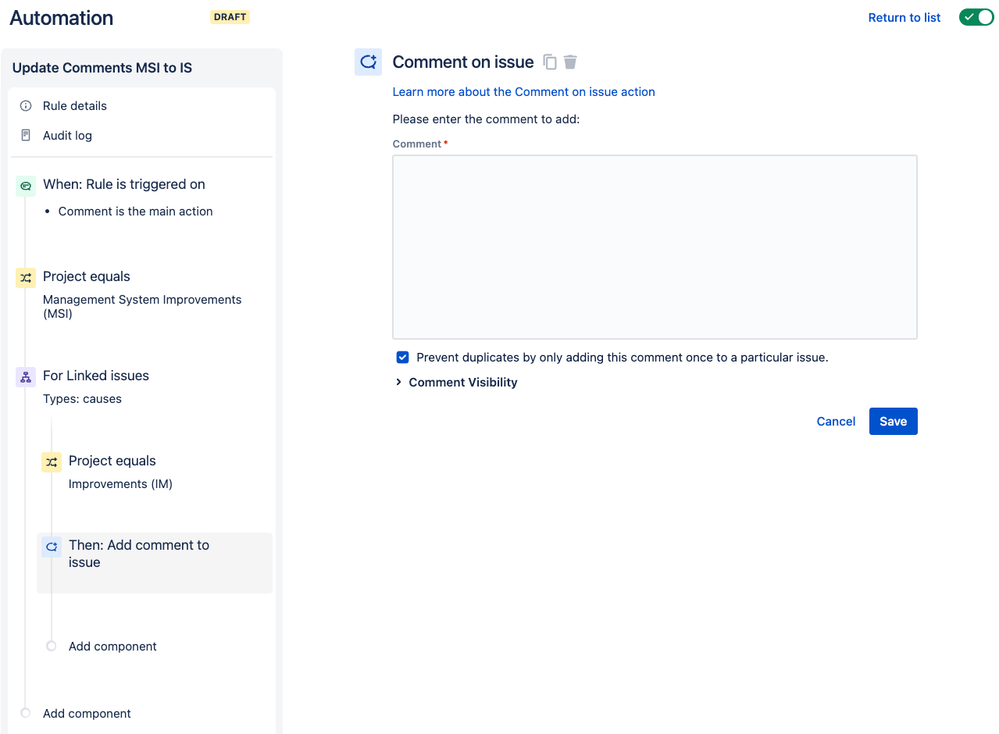

I don't get the comment-automation to work though. I have tried different configurations but no... I want the comment in the sw project (MSI) to be visible in the service project (IM) and vice versa. ( I understand I need to do two separate rules for this)
I am stuck on the last part on what to write/add in the Comment field in the "comment on issue" action.  As seen on the right side in the picture below. I have tried some options but haven't worked.
Not sure though if something else is incorrect with the rule. As you can see I have used "Rule is triggered on - Comment is the main action". Is this correct?
I have also tested with both Causes and Caused by as ink types in the Branch.

In your new rule where you are trying to copy comments the rule reads as:
  • When a comment is the main action
    • and the comment was added to an issue in the MSI project
  • For each linked issue where MSI issues causes the linked issue
    • and the linked issue is in the IM project
    • then add a comment to the linked issue (in the IM project)
In your For Linked Issues step the Type should be caused by.
For copying the comment, what elements of the comment do you want copied? This documentation shows the attributes you can get from the Comment that triggered the issue. You can insert those smart values into the Comment field in the Add Comment To action to copy the information from the trigger Comment to the new comment that you are adding.
If those changes don't get you the result you expect, please provide a copy of the rule Audit Log output for an execution of the rule with your next response.
