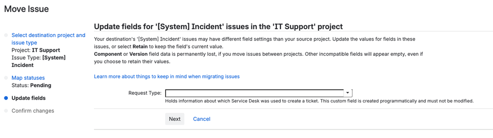

Each request type is tied to its work item type. If you are changing the work item type, all of the statuses would also be changed as well. This is considered as moving of a work item. It will also ask you which Request type needs to be applied. See the picture below.
In automation, you don't have a trigger when the work item is being changed to other work item type.
