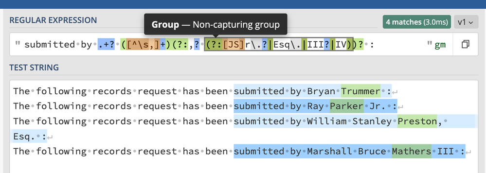

Ohhhh K, even though I just said you shouldn't try to do complex things like this, but I couldn't resist:
https://regex101.com/r/8OUOPm/1
submitted by .+? ([^\s,]+)(?:,? (?:[JS]r\.?|Esq\.|III?|IV))? :
(God I love this tool. Thank goodness that the tester has great hover-over explainer tooltips to tell me that ?: creates a non-capturing group, because I did not want to have to deal with grabbing a particular match.)
So yeah I just did some tests with Automation and it passed all the tests.
I guess the good thing is that the rule is a little easier to read and more explicit.
