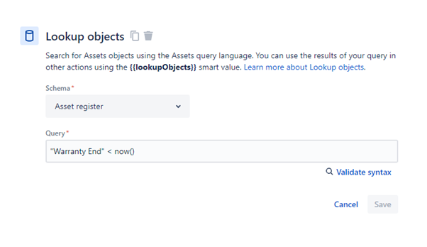

I'm trying to create an automation for the assets I have in Insights but am receiving the result : No issues were found, stopping the rule.
The automation is as follows:
> At 9am
> Lookup Objects from Schema "Asset register"
Query "Warranty End" < now()

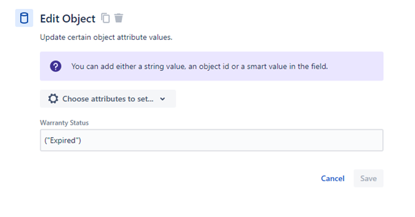

> And Edit object attributes: Warranty Status = ("Expired")

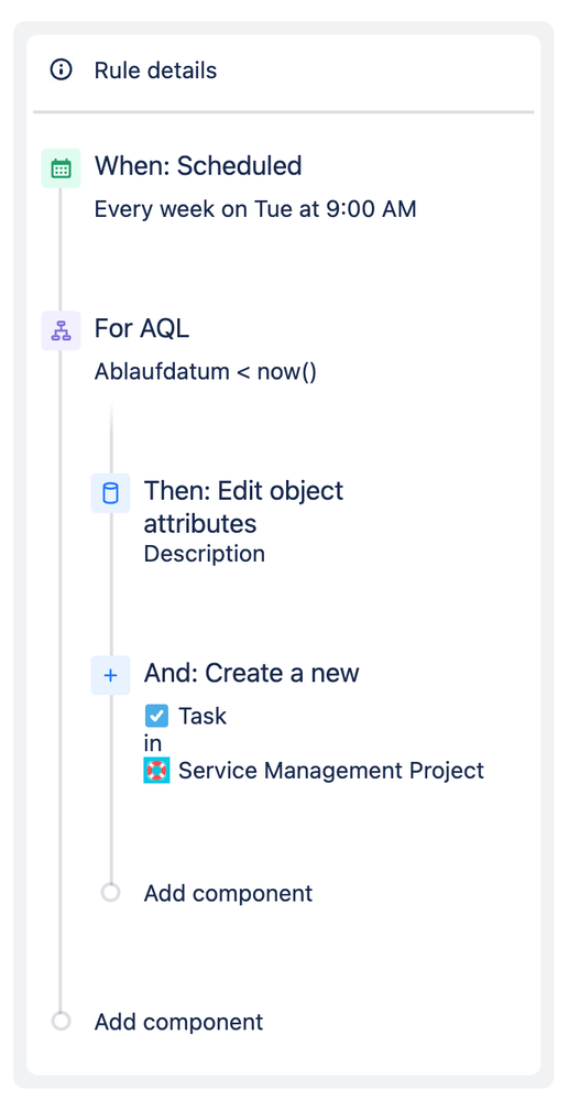

thanks for your question. Your starting point looks correct. Might be just a small piece missing. 🙂
Could you please post a screenshot of your rule config? You probably would want to branch on {{lookupObjects}} and for each entry use the create issue action.

hi @Trevor de Souza
thanks for the screenshots. Could you please try the following setup?

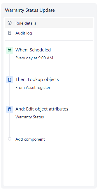

Thank you for responding and your assistance. Please see rule config below.
