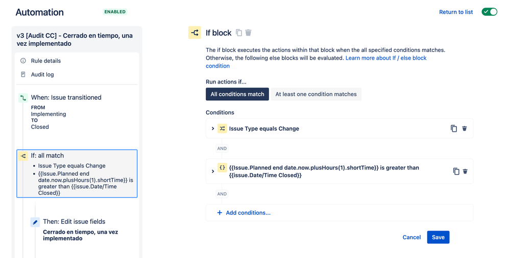

I'm trying to set up an automation that performs the following logic:
I have a field named Closed Date/Time that is filled in when closing a change via postFunction.
And we have the Planned End Date field that informs the end date/time of the implementation of the change.
The team has a deadline of 1 hour after the Planned end date to finalize the change, otherwise it would have to mark the change as unfulfilled.
But I'm having trouble setting up this expression.
Changes that have been resolved within 1 hour of the planned end date will be marked as completed and those that have passed the 1 hour mark as not completed, that's the idea.
Can you help me?

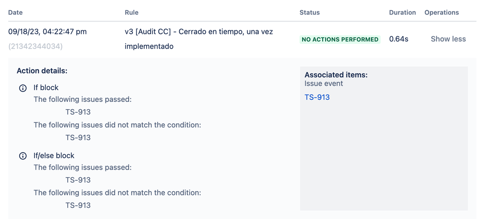

Have you tried to execute this Automation Rule? What is the outcome? What information is in the Audit Log for the rule execution?

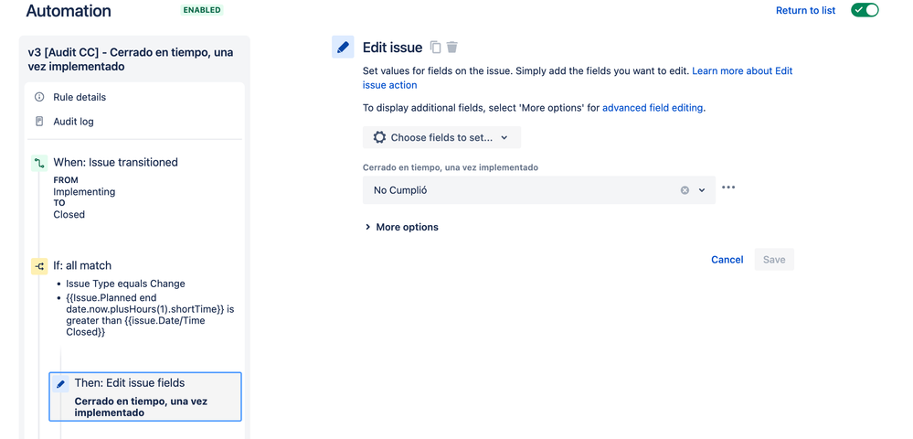

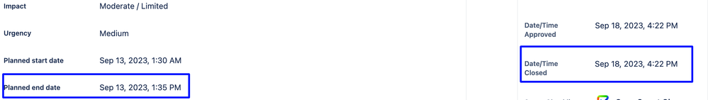

I'll share it with you, look at this example
The time in the Date/Time Closed field is greater than Planned end date+, the rule should have marked this ticket as unfulfilled.
I'll share all the details with you.

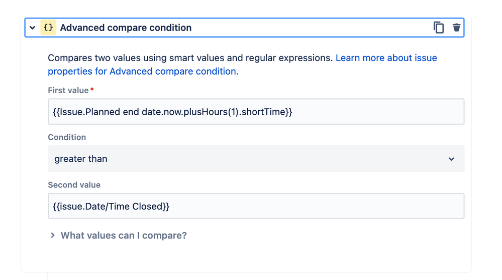

The first value of your compare is
{{issue.Planned End date.now.plusHours(1).shortTime}}
Have you tried using the Log action to print the actual value of that smart value into your Audit Log, to see if you are getting what you expect for that value? I think you will find that you are not getting what you expect.
If Planned End date is actually a date/time field, then to figure out what the right date/time is for one hour later would be:
{{issue.Planned End date.plusHours(1)}}
now is not appropriate to use within that smart value. now is used to get the current date and time.
Adding the format command shortTime to the smart value is also not appropriate. That would convert you date/time value to just a time value. In the comparison you are trying to compare to another date/time value. You can't effectively compare a time-only value to a date/time value.
