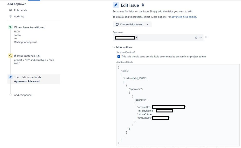

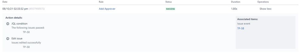

I set automation to add Approver and it says success in Audit log, but no approver is added. The person Im trying to add as a Approver is agent in my project.
I've tried both options separately (JSon format and Approvers field) and at once and nothing works. Always says "Success" but nothing happens. When I check the ticket through REST API no approver or any indication of the agent is present.
I just need to add someone/anyone as approver through Aumoatization to understand what Im doing wrong. Can someone please help me?

Can you share a screenshot of your rule audit log, approval configuration from workflow?
Josef Vozáb
October 8, 2021
Hi Alex,

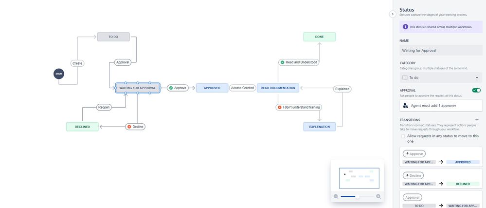

yes it is JSM project. I have in workflow "Waiting for Approval" status with Approval turned on - Agent must add approver. I wanted to change it for Admin if it helps, but I have to pre-select approver witch is something I dont want to do since Approvers will change.
When I set issue into "Waiting for Approval" status, "Add 1 approver" field appears and I can select one.
Here are screenshots from workflow and auditlog

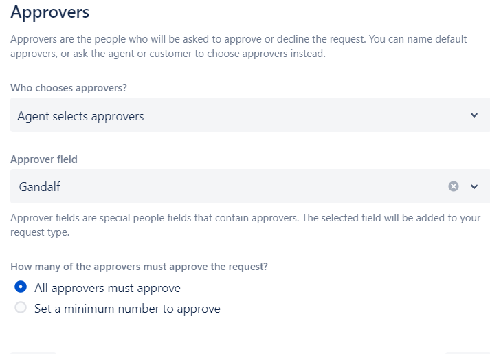

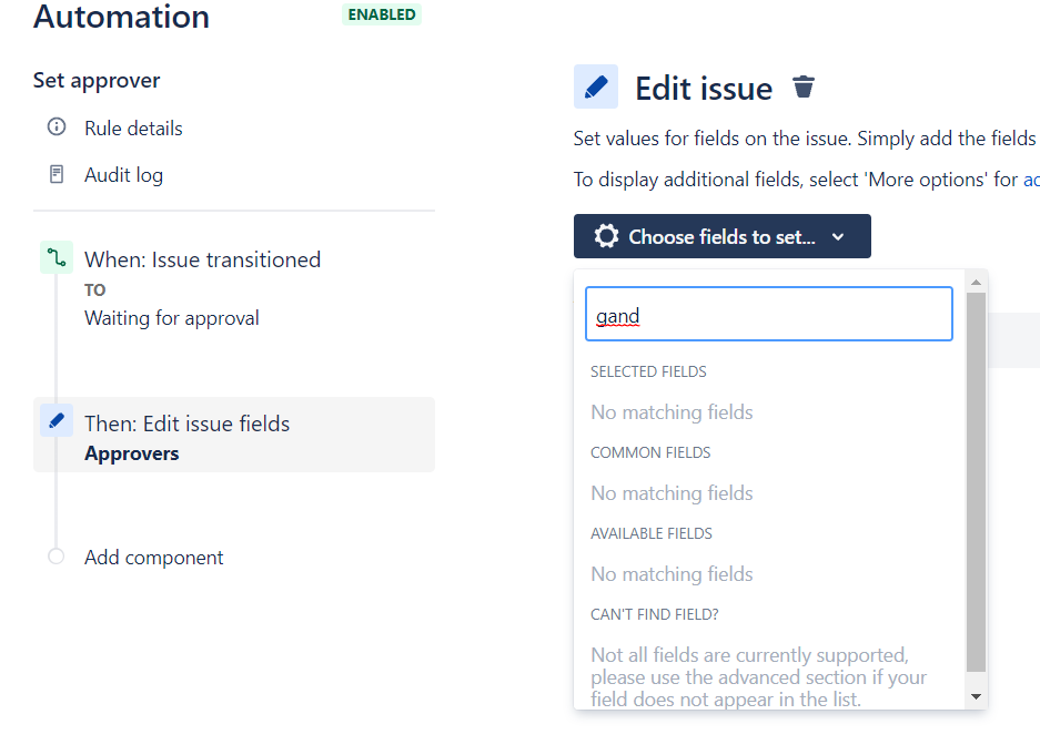

And here's the thing with this kind of project. I've created a new "approvers" field called "Gandalf" and chose this as the single source for approvers.
Once I went to the rule to find this field, so as to fill it within the automation, the project couldn't find it. So I presume that this field lives within the approval.
