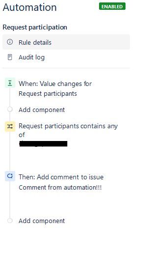

I am trying to set up very simple automation. We're getting mail to support mailbox with alias from the product:
product.support@company.com
Ticket is being created, Request participants are being set up properly according to alias after ticket creation but automation is not meeting the conditions.
No idea why it's not meeting condition. Anyone can see something wrong here?

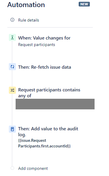

Hi @szymon_szostak
if you like you could test the following rule.
No guarantees given but I could imagine a timing issue. Also, at least there should be a log afterwards telling what Jira sees for the "Request Participant" that time:

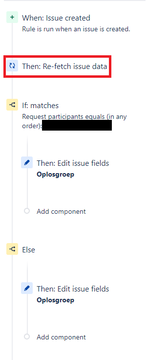

December 1, 2022
@szymon_szostak
This solution also solved our problem with the: "When: Issue created" trigger.
Looks like that "Request participants" is filled after the ticket creation.
"Re-fetch issue data" will fix this.
This is our Rule:
Halim men

Thank you @Daniel Ebers Re-fetch issue data solved my automation based on participants!

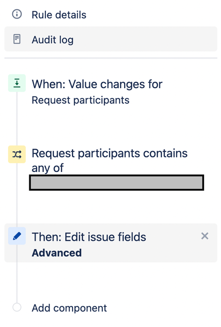

You have an interesting use case, one which I have never tried before. I sent an invite to the email id which was required to be confirmed and created the below rule which is working as expected.
I would suggest sending an invite to the mail id 'product.support@company.com' and then try.
Please accept the answer if this helps solve your query else respond and allow others to share input.

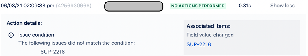

I have added incoming mail with alias at first place. Looks like automation is triggered correctly, but somehow, it's showing that conditions are not met.

This means that Jira is recognising the trigger properly but not the condition. I would suggest you test it with your id, which will help you identify the exact condition that needs to be configured.
Also, please confirm if you are able to see the alias in the drop while setting the condition. This is another indicator that it is working or not.

This is strange - I really think this is some kind of issue with order of things going on during the issue creation. When the mail comes, it creates a ticket and then it's adding the request participant. I believe it's somehow triggering it before it saves the participant.
I've done some test where I changed the trigger to work on update and I was changing the priority - it worked like a charm.

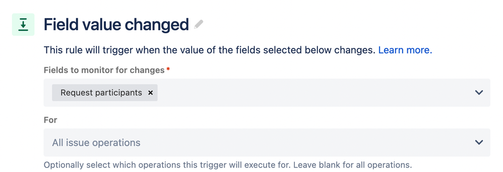

For the value changes trigger, did you set the operations to be for creation?
Regards
szymon_szostak
August 8, 2021
Hi! Thanks for answering.
It is set for all types of operations, so I guess it should catch it. I can see in the logs that it's triggered properly, but conditions are not met.
