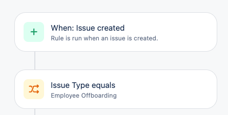

I'm not using a branch component.
Christian
May 31, 2024
Okay, that is good to know.
See this, the automation is triggered on issue created, there can really be only two reasons the content isn't populating:
