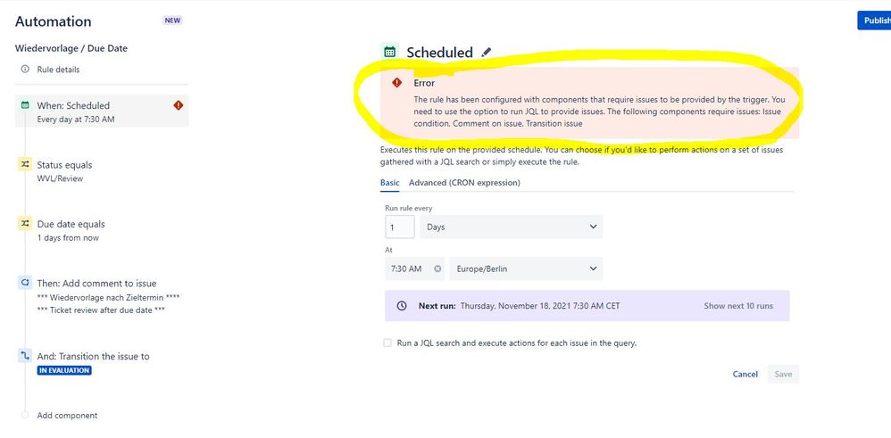

We store open issues in a "review" state with a due date. As soon as the due date is reached, the automation should change the status back to "in evaluation" and add a short comment. The rule should run every morning. Sounds easy but creates an error where I honestly don't know what to do now.
Any hint how we can set up the rule? Photo attached.

Hello @Rainer Daller
Currently, the rule is not fetching any issue to check the conditions. I would suggest adding a JQL condition. Use the check box under the box which lists the next run time.
The JQL can be as simple as "project = <project name>". This can be further customised to reduce the count of issues on which the rule executes.

Hello @Gaurav , thanks - it worked now (once) - then it said that our max of automation is reached for this month.
Can this be the case? We only have one automation yet which checks once a day. So I am wondering what this is counting.  We do have the "standard" price plan. Regards rainer
Rainer Daller
November 17, 2021
@Gaurav , found the setting. Everything is fine and works now. Million thanks for your help :)
