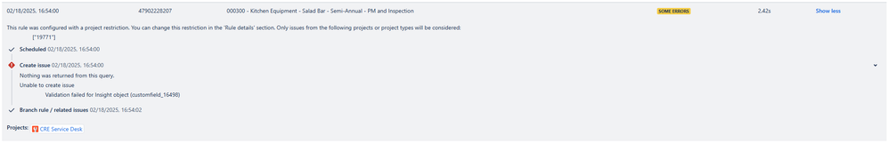

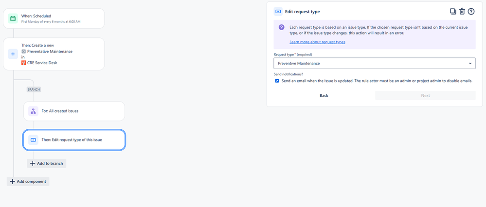

I am trying to setup an automation that uses a custom field to pull from an asset schema. This works for most of the assets but we get the error shown in the picture for some of them. There appears to be no rhyme or reason to the failure and all assets were imported from the same spreadsheet. Then the asset name copied and pasted into the AQL query.
All other queries work and the one custom field that is giving an error works 75% of the time.
Any insight on what might be causing the random issue?

  • an image of the audit log details showing the rule execution with all the areas expanded

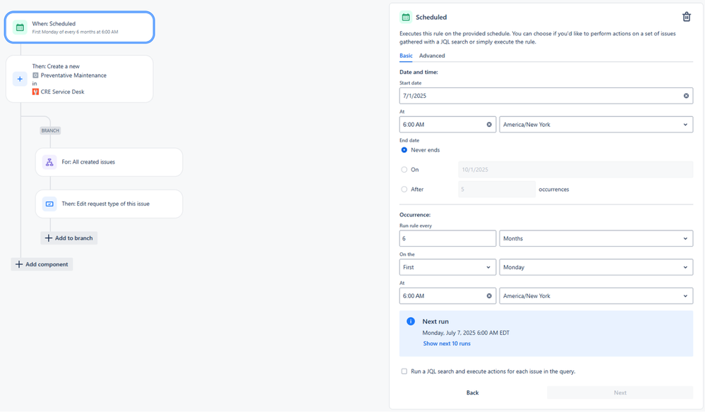

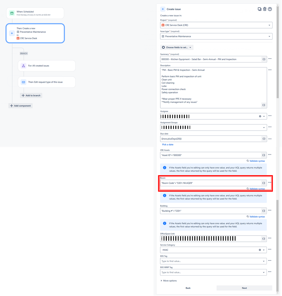

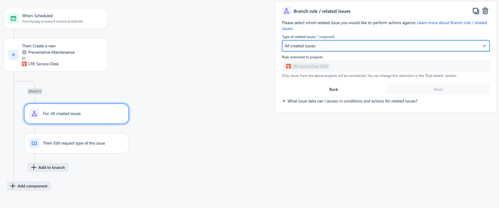

Below are pictures of the rule in order from schedule, to create, then branching.
My original post had the audit log details with all areas expanded.
I do not use JQL.
The field circled red in the 2nd pictures is the custom field referenced in the error message.
We are using JSM for our Facilities team so I have limited IT knowledge. :)
How do I store data in a created variable for use later?
How would this work if the automation was to run every week, month, quarter?
1-Automation-When Scheduled.png2-Automation-Then Create.png3-Automation-Branch For All.png4-Automation-Branch Then Edit.png

It appears the create is failing with the AQL for the "Room Code" lookup.
On that field edit, if you select "Validate syntax", what do you observe?  Is there a result count shown for matches?

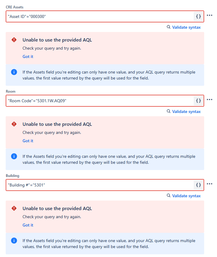

So I have never been able to have validate syntax return a result. It always gives an error. See picture.
I can confirm if I remove the Room custom field that the automation runs correctly and the AQLs run correctly for the other fields
I can also confirm that we have no other assets that are "5301.1W.AQ09" so this is the only result to pull.
I can also put other room codes in this field and the automation will run just fine the first time but it will fail on the 2nd run. At the same time we have others that will run without issue every time.

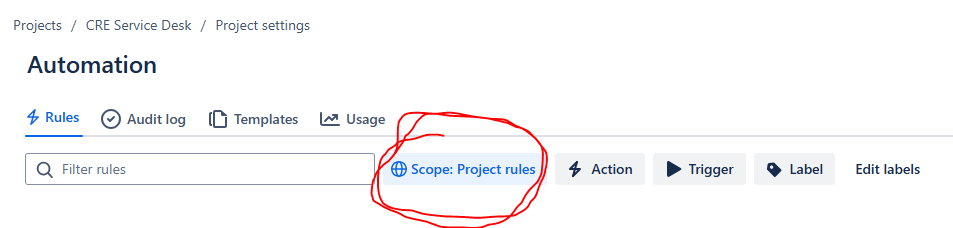

I believe that error is a rule scoping symptom.

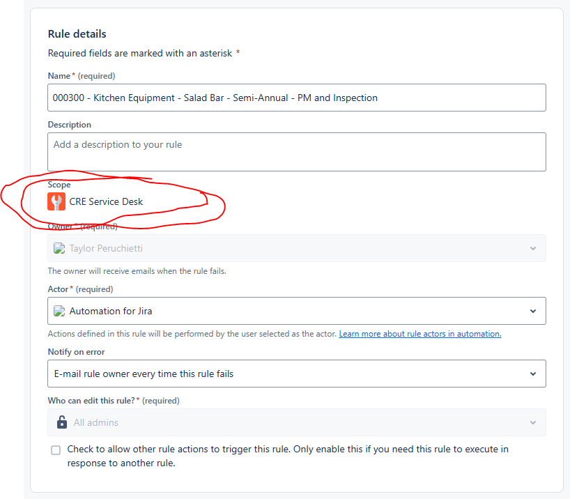

Is your rule single-project scope (in the details at the top)?  If so, to validate that AQL the rule must use a global scope...which a Site Admin will need to change.

For your specific rule in the rule editor, look at the Rule Details at the top-right.  On that view you will see the scope setting.
kara.decker@jackson.com
February 21, 2025
Is this what you are talking about where the scope is specific to our project?
Like Bill Sheboy likes this
Bill Sheboy
February 21, 2025
Yes, that is the one.
