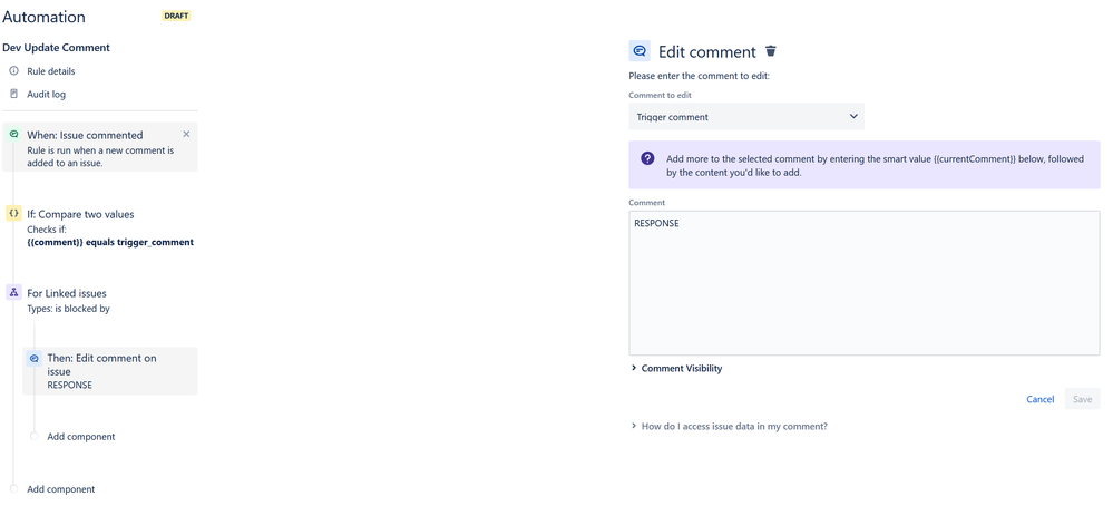

Hi all,
I'm trying to build a trigger that reacts to a certain comment and then loops through all issues linked with "blocked by".
So far no problem.
However, I would then add a comment (or edit the trigger comment) with some information from the linked ticket, e.g. status, fix version etc.
"Trigger comment" will give me an error:
No comment with given ID found for issue <linked_issue>.
Not sure why this would even look for the ID in the linked ticket?
I tried smartvalue {{comment.id}} but this seems to look for the ID in the linked ticket, not origin one, hence it wont find a comment to edit.
Any idea how to make this work?

But since it's a global/multi-project automation
  1. Trigger - Issue commented
  2. Action - Create a variable (store the desired commented value)
  3. Branch issues - will use linked issues on blocked (like you already did)
  4. Add the comment with the value of the variable created in the step 2.
I believe it would be a similar solution to what you would want.
