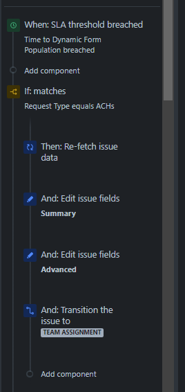

I have an issue where Jira Automation throws (Randomly) a 'Some Errors' error.
It normally processes fine, but I do not like to be alerted unless there is a true issue. The errors do not hinder the working of the ticket, but like I said. Failure allerting to be should be a true problem so I like to keep these types of notification to a minimum.
Here is the JSON used to update the Summary field with the Custom Field that is selected from a Select List (Single choice)
The list contains the Custom Field that we would like to see in the Summary.
{{customfield_10164.value}}
customfield_10164 is ACH Request Type and it has a list of 3 Custom Field in a drop down used by a Dynamic Form

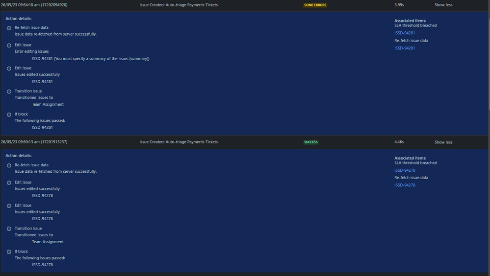

Here is the Action detail from the Some Errors in the audit log:
Error editing issues
ISSD-94281 (You must specify a summary of the issue. (summary))

Hi Joseph,
Can you share the full automation rule that you have and the audit log with the details of the false error that gets generated?

I have attached a Successful log and a Some Errors log.
Please let me know if the automation set up needs to be more granular!
Thanks!

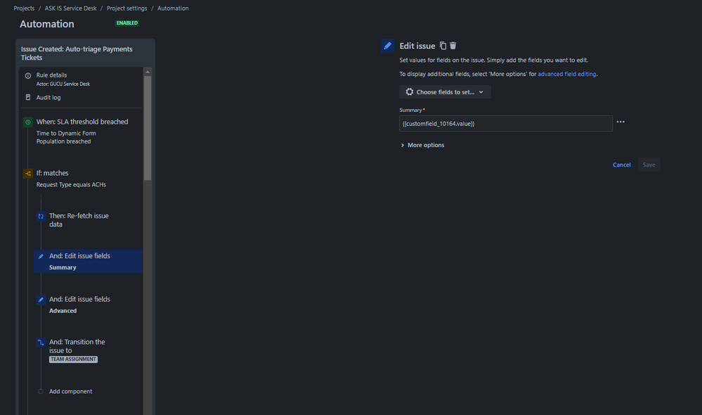

Can you show the details of the summary edit step?
Joseph Nicholls
May 30, 2023
Here is the Edit Issue area that is throwing the "error"

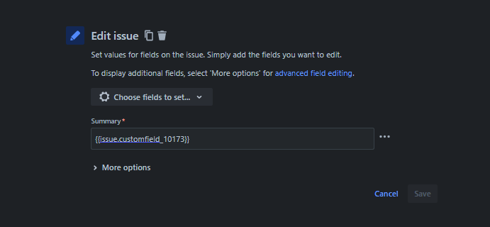

Try using {{issue.customfield_10164}} for the Summary field edit.
Joseph Nicholls
May 31, 2023

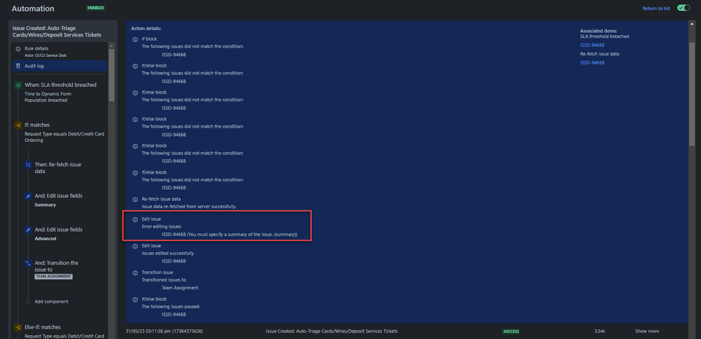

I tried that and am still sporadically getting the Some Error as above.

I think that I might have found the issue. I think that it does not like the customfield_*
It seems to want the name of the Custom Field. For the example above, customfield_10173, the field name is Deposit Services Request Type. If I change it to {{issue.Deposit Services Request Type}}, it appears to not fail.
Still working to validate this issue further.
John Funk
June 23, 2023
That's very strange. I have had the customfield value work before when the name would not. But not vice versa.
