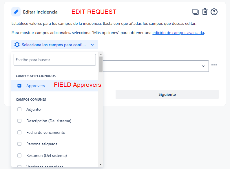

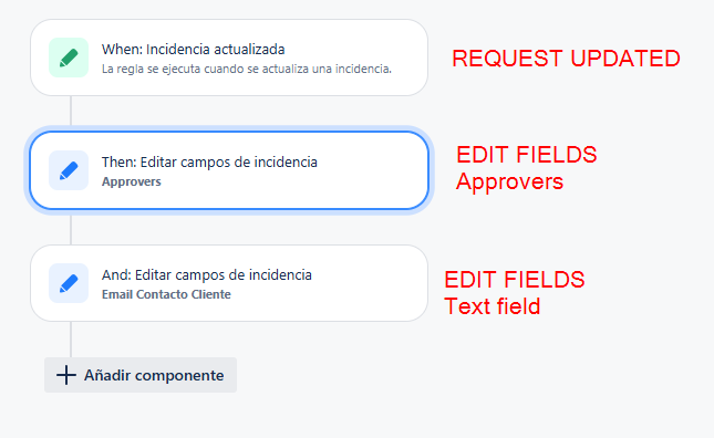

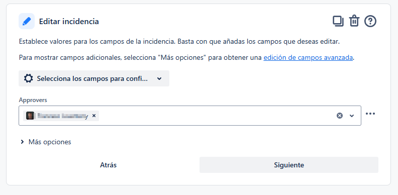

I need an automation to set the approver of the issue based on the value of a field.
I have done a simple test, updating the issue fields when it is modified, but I cannot get the Approvers field to be updated. It does modify a text type field.
Approvers action...
With this automation, the text field is updated. But nothing changes in Approvers.
What am I doing wrong?
Thank you!

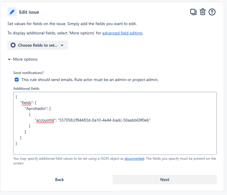

We finally found this solution.
It seems that the user list fields don't work properly out of the box, but they do work in this other, more complex way...

The Approvers field was created where configuring the workflow, for the status needed to be approved.

Manoj Kumar Gangwar
November 27, 2024
Hi @Francesc Juventeny, the Automation rule looks good. Could you please share a screenshot of the audit logs to check the issue?
