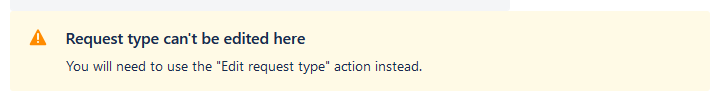

I am trying to setup this behavior using the automation system, but when I try to add the "Request Type" field to the ticket I'm given this error,
I then add "Edit request type" as an additional step to the automation, to set the Request type, but this results in needing to change the "When: Scheduled" step.

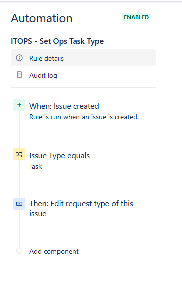

Thank you for the idea! I took a shot at putting it in place, and while I believe everything looks right for the automation to run it isn't making changes to new Tasks being created.
I feel like I must be missing something obvious here 🤔

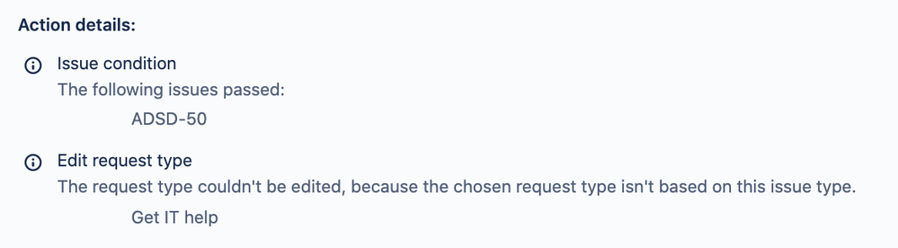

You can check the Audit log of your automation rule and see what errors may have occurred during execution. If the cause is what I described above, you should see something like this in the logs:
Screenshot 2021-11-02 at 12.00.31.pngTo solve that, navigate to Project Settings / Request Types, create a request type and link it to issue type Task. Then, update your automation rule to set that specific issue type upon creation of a task.
