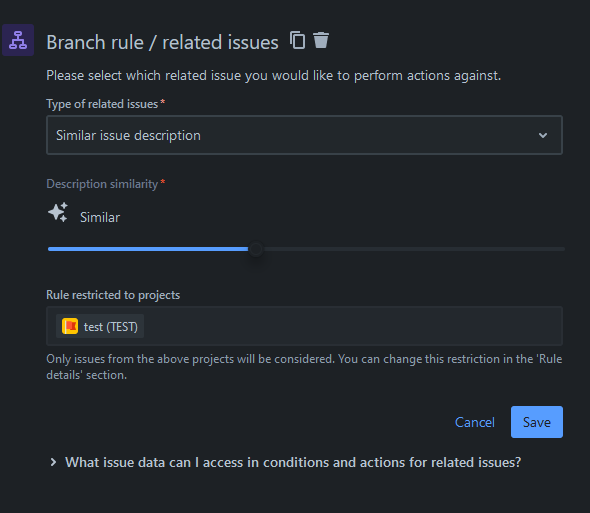

Tim Perrault
June 30, 2023
Hi @Michael Allen
You could try branching the rule and use the similar issue description option. That might get you where you are trying to go.
