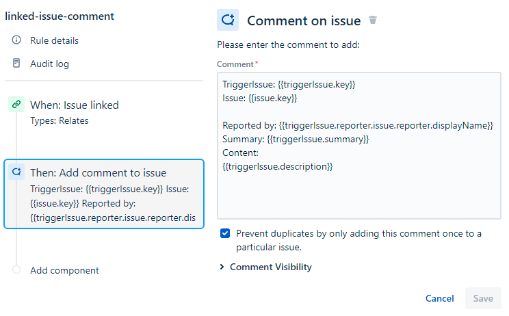

Here's the rule:
And the resulting comment generated on Issue-B:
TriggerIssue: Issue-B
Issue: Issue-B
Reported by:
Summary: Summary of Issue-B
Content:

Hi @Keiran ,
You need to branch out to issue A a after is linked. More details here: https://support.atlassian.com/cloud-automation/docs/what-is-rule-branching/
I would also use another link relationship as "relates to" is the same name for both inward and outward.

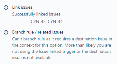

I'm attempting to merge the independent rule into a larger flow that performs the link:
Is this possible?  Alternatively can the outcome of an automation trigger other automations (it doesn't seem to)?
