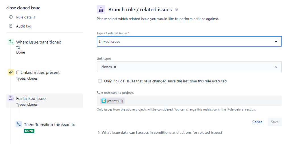

Hi @Ben Weisman ,
As far as I got your requirement correctly the following automation rule should behave as expected:
Looking forward to your feedback.
Best
Stefan

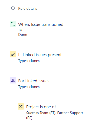

Ben Weisman
March 1, 2022
Thanks @Stefan Salzl . One question. I only want this to happen if the original issue is a couple of specific projects. To achieve this, I would just add a condition like I attached here? Screenshot 2022-03-01 133831.png
Like Stefan Salzl likes this
Stefan Salzl
March 1, 2022
exactly 💪🏼 you nailed it 😉
Stefan Salzl
March 1, 2022
ooooh....one thing:
be aware that the rule has then to be configured as multi-project or global rule 👍🏼
