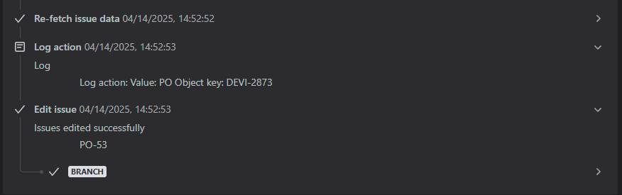

If I run it with my advanced JSON as before with logging, i get this log:
Create object
Lookup objects
Create variable
Log action
Log
DEBUG: Key for Edit Issue = [AST-2765]
Edit issue04/11/2025, 13:41:56
Issues edited successfully
PO-44
According to the log, everything is fine.
But it does not automatically change in the issue.

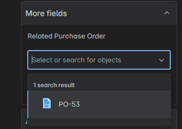

I'm starting to wonder if it is even possible? Since the field is using this + sign
https://imgur.com/a/nhhu2Az

And this is how I want it to look:
https://imgur.com/a/cney3Cu

Hi @Jakob Lindström
You should add a re-fetch issue data before editing.
The editing can be done without creating the variable.
In the edit action select the field to be edited (in your case Related Purchase Order)
Then use the smart value: key in {{lookupObjects}}

April 14, 2025
Hi Marc,
It just doesn't work.
I've gone thru the documentation multiple times now.
It even says that Issues edited successfully. But still doesn't change
But I can choose it manually.
I've also double checked my permissions and I've tried to run it as Jira Automation or as myself as admin.

Stop doing the edit like this.
Do the editing like this:
Like • # people like this
Jakob Lindström
April 14, 2025
Omg.
I'm so stupid. I was positive that i've already tried that.
But obviously not.
Thanks a lot @Marc -Devoteam-
