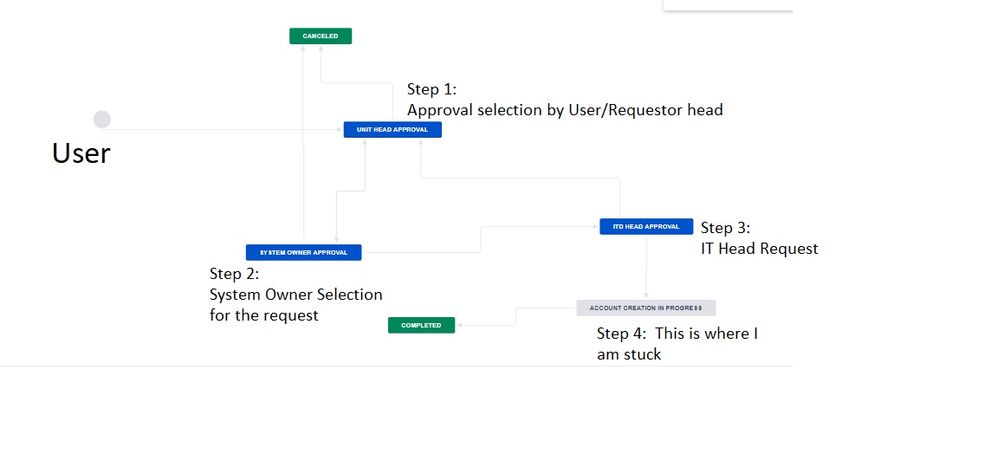

2. Please refer to the workflow screen capture, I am currently stuck at 4, once the IT Head approve (he receive an email with Approve/Reject button), it seems like the supposed to be IT Engineer also has the same mentioned button. If I am not mistaken, there should be a Resolved or Close button right?

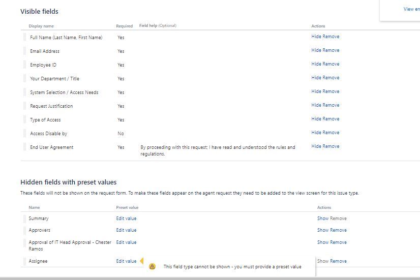

3. At the moment, "Assignee" custom field is hidden by default, is there a way to unhide it and input the email address of the IT Engineer accountable for the ticket type? (Or I can create a new custom field)
Looking forward for your help and assistance:
1. Below is the Customized form for a Service Request:
(As you can see , I need to enter the "assignee's email address" as the assignee custom field cannot be shown with the form, in other words each form will have different assignee email address)
2. Below is what a typical form looks like.

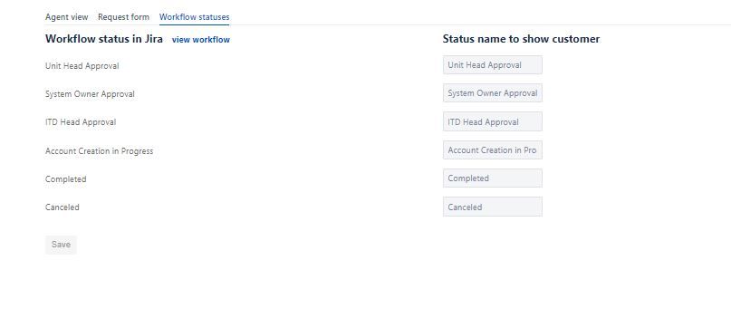

3. Here are my workflow for such and workflow Statuses for the form above:
From the process flow , where does the custom field "Assignee" comes in?
