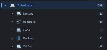

We are looking at two object schemas - one for people/users with 1 object type "People", and one for IT assets containing multiple object types (e.g., "Laptops", "Mobile phones"...)image.png

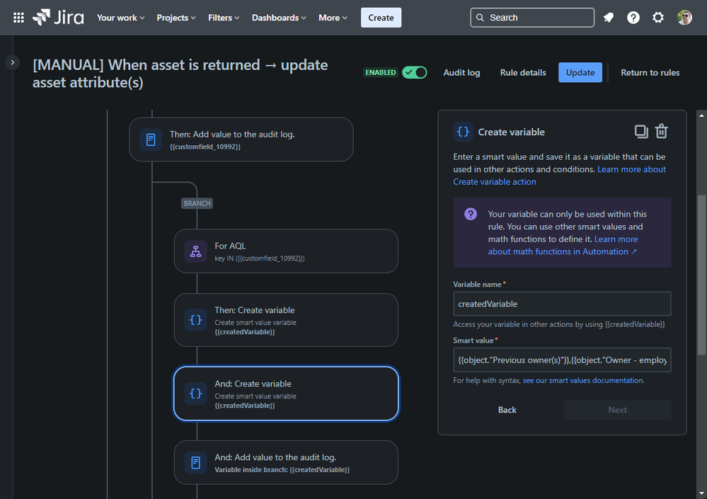

Automation is using the following solution for appending the values to object attribute: https://confluence.atlassian.com/jirakb/how-to-append-objects-to-an-assets-object-attribute-using-automation-1283493731.html

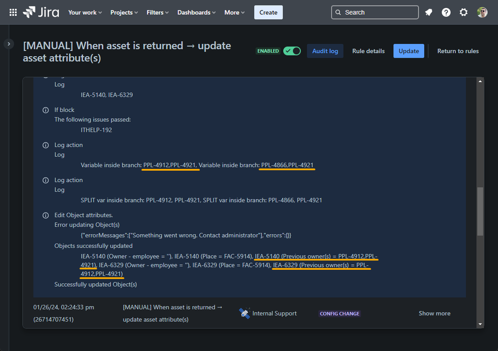

Now, according to rule logs, created variable is correct upon creating but once it is used in Edit Assets field attribute action, it updates both objects with 'same' values and I end up with the following result:
  • Object 1 ("Previous owner(s)"): Person A, Tomislav Tobijas
  • Object 2 ("Previous owner(s)"): Person A, Tomislav Tobijas (❌ not ok)

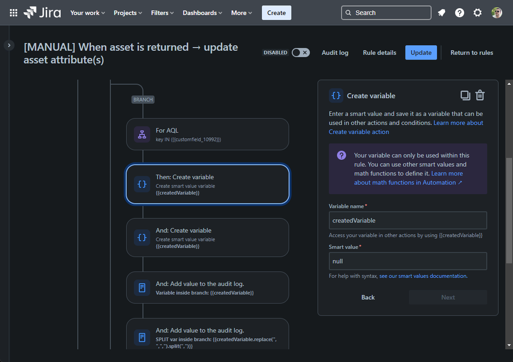

I'm wondering if I'm missing something here? Does the automation and (AQL) branching work in a way that if there are multiple objects inside branch:
  1. Iteration 1: For object 1 > create variable
  2. Iteration 1: For object 1 > update attributes
  3. Iteration 2: For object 2 > create variable
  4. Iteration 2: For object 2 > update attributes
Or does it work in some other mysterious ways? 😅

Inside the branch, your rule appears to create a variable with the same name twice in a row, although I cannot see the details of the value being set.  What is the purpose of those actions?
Until that is clarified...
Please note that branches which could process more than one thing are run in parallel and asynchronously.  And there is no guarantee of when the branch will complete, up to the last step of the rule.
What this means is things which happen inside that type of branch stay inside of there, and cease to exist outside of each iteration / loop.  The exception is anything written / saved to the cloud.  If you are expecting that variable to persist and be updated, that cannot happen.
In the first action, we just wanted to 'reset' the variable to see how the system will behave. Feel free to ignore this part as I've removed this first Create variable action and left only the 'second' one (stated in original post).

In my case, it seems that variables from different branches somehow overlap (at least that's how I see it) and there is no clear pattern when or how it works. When you have two objects where "Previous owner(s)" are the same people, it works okay. But when they are different users (whether one or multiple), I usually get different results. I've tested multiple iterations where I've changed "Previous owner(s)" values and here are the results: https://koios.atlassian.net/wiki/external/MTk4ZGQyMGJkNmY2NGYyYzg1OTk3ZjlhNzFkNmQ0MDg

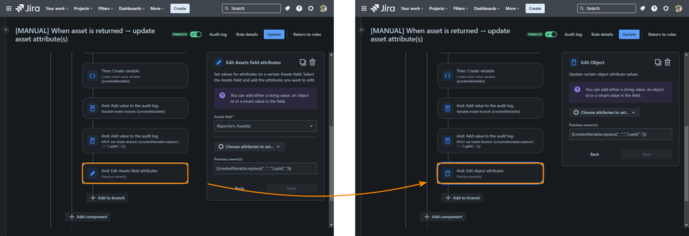

Before I added branching/iteration, the action for updating assets/objects was Edit Assets field attributes. As, initially, we only had one asset linked to an issue, that was fine. I forgot to take in consideration that this actually updates all assets in specified Jira field, even if there are multiple objects added.
Once the iteration was added, variable creation and branching was okay, but in each iteration, automation action would update both objects and not only the one from current iteration.
Basically, the only thing I had to do is to replace mentioned action with Edit object attributes (which actually looks current object from branch iteration), and everything worked like a charm.Replace action.png
@Bill Sheboy , thanks for the help here! I needed second pair of eyes and the guidance you provided to resolve this. Much appreciated 😄
