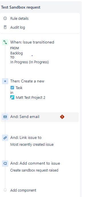

I'm looking to automate creating a new issue on project 2, when project 1 is transitioned to a given status. I appear to have done this part as it works as I want it to. However, part of the automation is to send an email to advise project 2 that the task has been created and this isnt working as i'd hoped.
Having reviewed other posts on here, I found the user of the "trigger" smart value but believe this will reference project 1 when i want it to quote the issue key and summary for project 2. . Can anyone advise what i need to use?

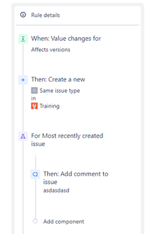

@Matt Hine and in order to comment on the most recent created issue, you can add a branch rule:
However you should change the rule's scope to multiple projects in order to be able to use this component properly.
@Alex Koxaras -Relational- - I have only created something using test projects at the moment. The automation works, so the new task is created on project 2 and a note i added to confirm this in project 1. It also sends the email as its meant to. The issue is the subject quotes the key and description for project 1, where as I need it to quote the information for project 2. Just need to understand what smart value (or prefix to the smart value i am using e.g. issue.key/issue.description.
Then use the branch rule and place there the send email component. Then use the {{issue.key}} smart value
@Alex Koxaras -Relational- - i have added the branch rule as you sugested above. Unfortunately, the rule is restricted to project 1 only. It doesn't let me remove this or add any other projects. It says underneath this section "Only issues from the above projects will be considered. You can change this restriction in the 'Rule details' section." But i cant find where i can update it to remove project 1 and include project 2.
Yes, I know, that's why I told you that you have to change the rule's scope to multiple projects. This can be done from the global automation page and only a jira admin can do it. But you shouldn't remove any project. Just add project 2 next to project 1.
@Alex Koxaras -Relational- - my apologies, i must have missed that part. I have now updated to include both projects.

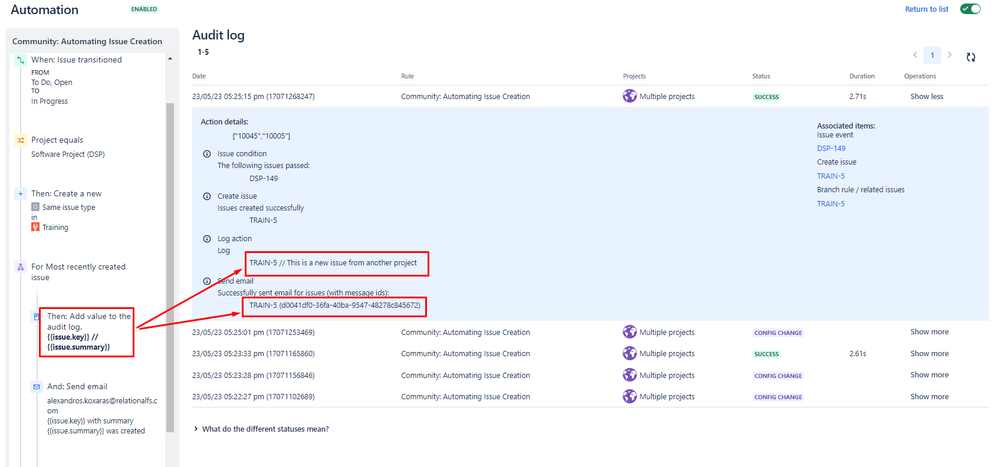

You have to add an if statement after the trigger and check that the project is indeed project 1. If not, then the rule should stop. So add a simple "Issue fields condition" that project field is equal to "Project 1".

Let me create the rule and get back to you

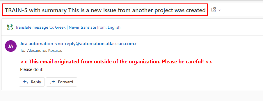

I've created the following rule, exactly like yours, and it works as expected:
Project 1 = DSP
Project 2 = TRAIN
I transitioned the issue to in progress on my DSP project, and created a new TRAIN issue. The email was sent to me with the new issue key:
