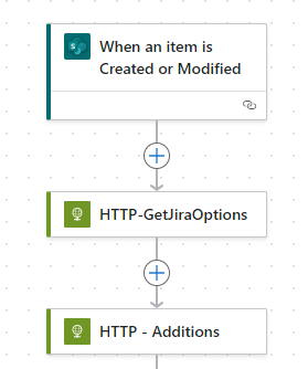

Im trying to automate a Custom Field in JSM from a Microsoft List. In the list we have 150+ locations which I want to be able to select in the Custom field.
I have set up a Power Automate flow, connected the list and got GET and POST to work, however im not sure this is the best approach? I also want to be able to Delete and change an entry if its name is updated in the list (post will only add a new entry if the name is changed)
Current Setup: Skärmbild 2025-01-20 130254.png
Power Automate flow, connected to MS List.
Trigger: "When an item is Created or Modified" -> HTTP with GET -> HTTP with POST (successfully adds new entries but doesnt change name or delete entries)
Using URI: rest/api/3/field/customfield_100xx/context/102xx/option which get my CustomField including the Values.

What I cant get my head around is that to delete an entry, I need to have two values, both the ID and the Name. And compare the values between the MSList and whats already in the API list somehow.
I don't know very much of JSON scripting..
