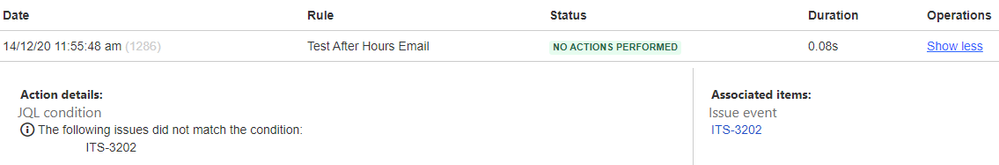

I've tried setting it up as suggested, but doesn't seem to be working properly. However I may not have set it up correctly. Would you be able to correct me as to if I've done this correctly?
Steps taken:
  1. Create a working hours calendar for our business hours
  2. Create an SLA titled "WorkHours" with the working hours calendar
    1. Start field is "Issue Created"
    2. Stop field is "Entered Status: Resolved"
  3. Project Settings > Project Automation
  4. Create a new rule with these details:
    1. Run when Issue Created
    2. If issue matches JQL "WorkHours" != withinCalendarHours()
    3. Then: Send email to reported
The rule seems to run, but no action is ever performed. The test calendar hours don't include Monday as a working day, so that's not the issue. I've attached a screenshot of the rule's audit log.

Hi @Chris Murphy ,
it's ok :-) I've just tested it using AfJ 7.2.4 and JSD 4.8.0.
When I insert some concrete user email into the automation rule, it is working.
But when I'm sending email to the reporter, it is not working and I can see in the log, that issue did not match the condition.
This is really strange, because the recipient of the mail shouldn't affect the JQL condition.
I will try to find some other solution and get back to you ASAP.

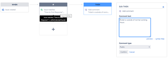

Hana Kučerová
January 9, 2021
Hi @Chris Murphy ,
I was able to make it work, but using the original automation functionality. now the new one (it seems to me there's some kind of bug).
The configuration is almost the same. Instead of sending mail I used "Add comment" action, which creates public comment (and based on the public comment the mail to customer is send - "Public comment added" customer notification must be enabled).
Please try.

1. Create a calendar with our working hours titled "Working Hours"
2. Create an SLA titled "Working Hours" with the conditions set to Start on "Issue Created" and to stop when the issue enters "Resolved" status
3. Create an automation rule for:
When: Issue Created
If: Issue matches: "Working Hours" != withinCalendarHours()
Then: Add Comment

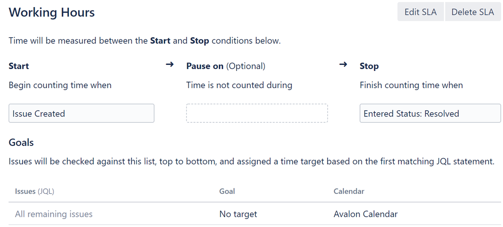

Hana Kučerová
January 11, 2021
Hi @Chris Murphy ,
please try to add some target to your SLA like - All remaining issues - 2h - Avalon Calendar...
Chris Murphy
January 12, 2021
Awesome, that worked, thanks a bunch! Rule is now functioning properly :) Much appreciated!

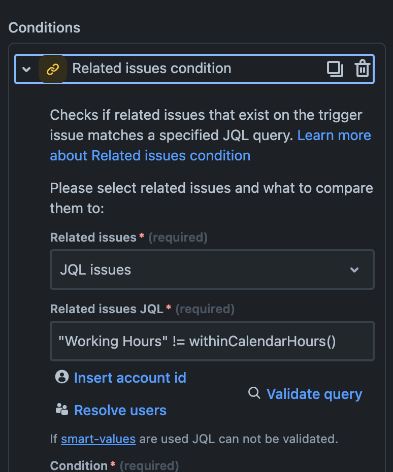

Jakub Koc
March 7, 2024
@ROUSSEAU Corentin the solution above didn't work entirerly for me either, instead I found this https://community.atlassian.com/t5/Jira-Service-Management/Automation-for-Out-of-Hours/qaq-p/2333663 which helped me somehow but in the end I created something similiar to the above.
Trigger: Issue created
If/else with Issue related condition and the rest states as below.
The required condition at the bottom you have to set to "Are present".
Hope that helps
