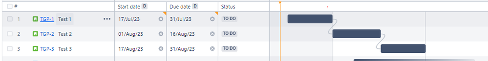

For Example:
I have a project with 3 stories with some dates.
1. Test-1 - 17th Jul- 31st Jul
2. Test-2 - 1st Aug - 16th Aug
3. Test -3  -  17th Aug - 31st Aug
Now If "TEST-1" cannot be completed in time and takes 1 day extra. (i.e., completes on 1st Aug). I need the "TEST-2" task to be automatically changed to 2nd Aug - 17th Aug and the Third should start on with 18th Aug - 1st Sep.

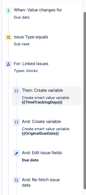

Trudy P Claspill
July 14, 2023
Hello @Spartans
You have said that you are using Advanced Roadmaps, but you have also tagged your post as being for the Free version of the product. The Free version of the product doesn't include Advanced Roadmaps.
Are you using a Trial or Paid subscription of the Premium product?
You can use auto-scheduling in AR to automatically adjust dates on dependent issues, but it will adjust other issue dates also.
If you don't want to use auto-scheduling, then you can adjust dates through Automation Rules with a rule like this:
However, what you end up creating is a rule that detects a change made by a previous execution of the same rule, and causing the rule to be called again for a new issue. There is a limit to how many times Jira allows that to happen, and that limit is 10. If you had a chain of dependencies of more than 10 issues, the Automation Rule would not be able to update all of the dependent issues.

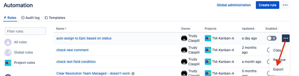

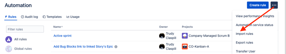

Trudy P Claspill
July 16, 2023
I said you would need to use a rule like the one I provided. You would need to adjust it for your use case specifically. My use case was for sub-tasks. Based on the image your use case is for a different issue type, so you would need to modify the rule.
The code you have been given is what one gets when one uses the Export feature to export an Automation Rule. It is still an automation rule, but in a different format.
You can't paste the code into a Rule. You have to import the code so it will create a Rule. Rules can be imported only from the Global Automation page.

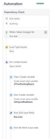

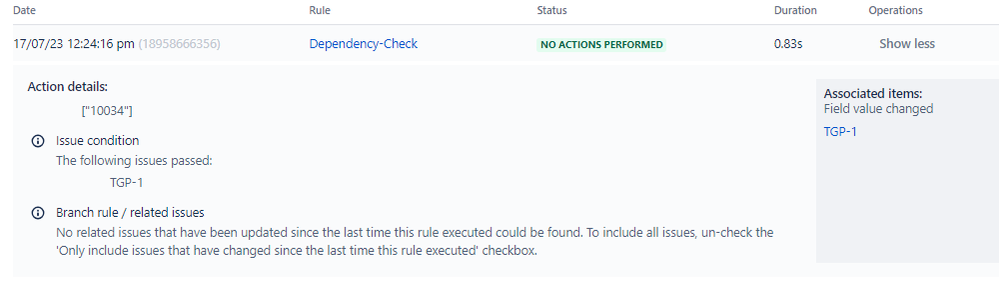

Spartans
July 17, 2023
I tried as per your automation, but its getting success and since I'm trying on a sample project to test it. If it gets success then I can apply it in our Project.
Also I have created only stories. So I chose stories Issue type = Story.
Attaching the Screenshot

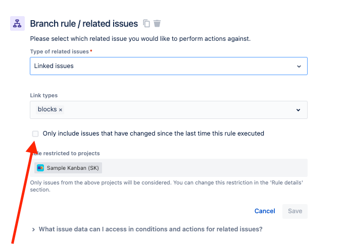

Trudy P Claspill
July 17, 2023
Is there a reason you have not simply imported the Automation Rule code you were given, with the help of a Jira Administrator if you don't have sufficient access?
Regarding your attempt to recreate the rule I provided as an example, the message is indicating you have this box checked.
Is it your intention to only update linked issues that have been updated since the last time the rule executed?
