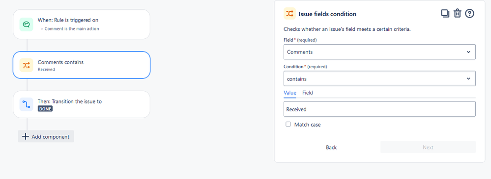

Hi,
So I have an automation that when an issue is transitioned to a certain status, the requestor gets an email similar to below:
"Please acknowledge that you have received your item from the Procurement Team by responding to this email with "Received" in the body email."
The requestor responds with Received and that adds the comment back onto the issue.
That seems to be working.
However, the issue is, when that comment comes in, I want to transition the issue to a closed status.
I can't seem to get the attached automation working for that and I am not too sure where the issue is?
Thanks.

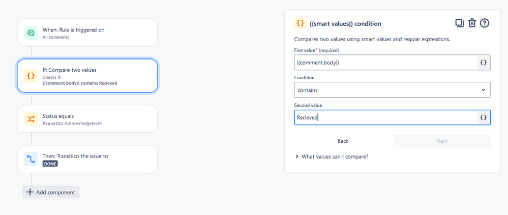

Drishti Maharaj
September 5, 2024
Figured it out lol we had a minor spelling issue looking at the comment received via email 😅
Jack Brickey
September 5, 2024
Hi @Drishti Maharaj , what does your audit log show when the rule is triggered? Is it possible that there is not a transition to Done in the current status when commented?
Drishti Maharaj
September 5, 2024
Hi @Jack Brickey - the audit log shows "No actions performed"
I think the issue might be on the field I picked.
I picked "comments" but I am not too sure if that is the standard field within JIRA itself?
So I do have a transition between that current status to Closed.

Drishti Maharaj
September 5, 2024
Hi @Jack Brickey , I even tried to edit the automation to use the smart values as attached, but the audit log still shows "no actions performed".
